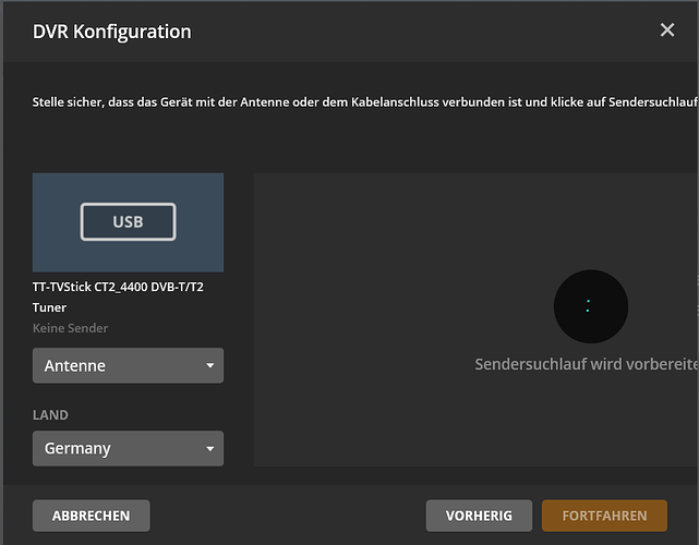

Same thing happens for the TechnoTrend TT-TVStick CT2-4400. It’s a BDA-compatible multi tuner for DVB-T/T2/C, but only the terrestrial/antenna tuner is listed during setup in PMS.
I’ve tried again on a different server but the end result is still the same.
According to the log, both the cable and terrestrial tuners of the TT-TVStick CT4400 are correctly identified. However, in the UI only the DVB-T/T2 tuner is surfaced.
When I try to run a channel scan, I only get a greyed-out button and can’t progress any further.
