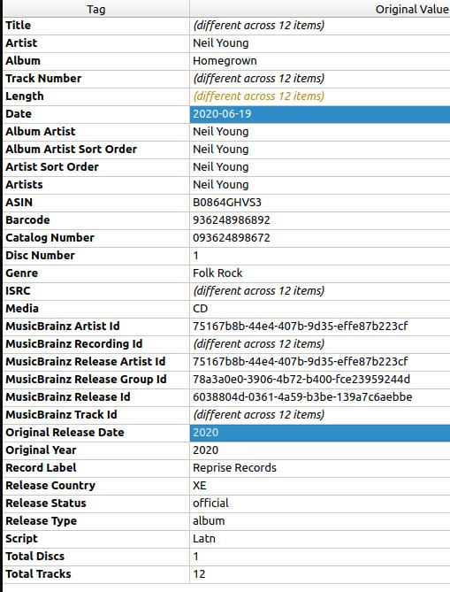

I suspect the answer to this is no but let me ask regardless. Lets take this scenario…
So, the specifics, for the ID3v2.3 date tag it supports yyyy-mm-dd whereas originaldate only supports yyyy. See screenshot below for details:
Screenshot from 2022-11-26 14-05-43
Then when everything gets matched with plex the Originally Available (which is populated from originaldate) come into plex using yyyy adding the default 01-01 for the 1st Jan.
Screenshot from 2022-11-26 14-14-30
Why is this a problem, well date sorting is a mess. Sorting is only done on the year and it also makes the plexamp feature of On This Day useless.
So, I’m looking to see if there is a way I could somehow workaround this limitation. Was thinking if there was a override I could use to force plex to use the date tag instead ? If so as it supports yyyy-mm-dd I could just ensure the date tag is correct and all would be well.
Not using Prefer local metadata is not an option for me. Also, with ID3v2.4 the originaldate tag supports yyyy-mm-dd but that’s not an option as it breaks releasetype.
Anyone any other recommendation ? Manual editing multiple thousands of albums is also not really an option.

I’ve been able to workout a solution to this and I’ll post it here for anyone else who might find it useful.
Basically I asked myself what if… the originaldate tag didn’t exits in my files, would plex fallback to just use the date tag? It does!
So, I removed originaldate and for good measure originalyear so my tags updated to this …
Screenshot from 2022-11-26 15-53-24
… and then done force refreshed the album (didn’t even need a plex dance) and boom the full date came in !

So I think what I’ll do to workaround this is a two step approach:
  • When I initially add my tags I’ll make sure to set date = originaldate, something like this $set(date,$if2(%originaldate%,%date%)) but will need to test some more to get the code right.
  • Then do a second tag update to JUST remove originaldate and originalyear leaving everything else untouched.
EDIT: Was able to do the above with one step by adding the following code to my musicbrainz scripting under options:
$delete(originaldate)
$delete(originalyear)
I believe this will give me fairly accurate release date information, at least it should be better and no worse than I have now.
