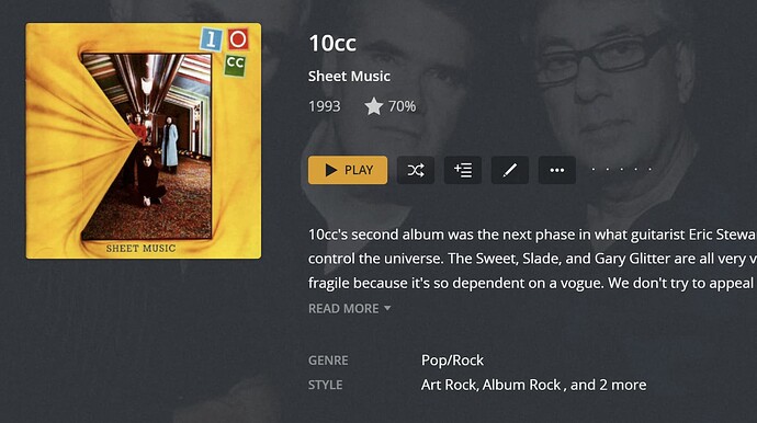

I am adding music to the server running on my NAS, and though the files are perfectly tagged and also follow the directory guidelines, the release dates keep being incorrectly set.
For example (this is one of lots), “10cc - Sheet Music”
This is an album from 1974 and when added to Plex, it has the release date set to 1993. Not only does it do that, it also alters the files own tags to 1993 (i have set the files all to write protected so i do not have to keep re-tagging them after each failed attempt at fixing).
I have the Agents with Local Media Assets enabled and set first in all places, and have the library set as Plex Music for both Agent and Scanner, and also ‘prefer local metadata’ is ticked.

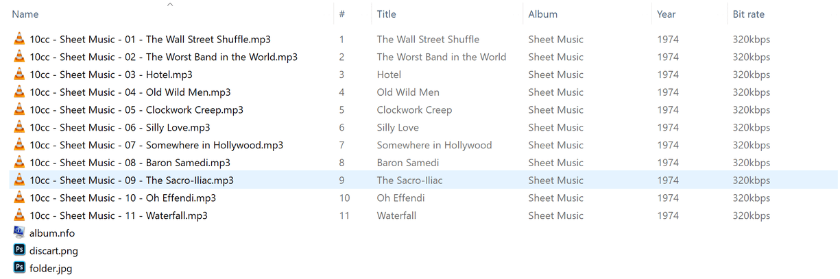

As an example, there is the folder

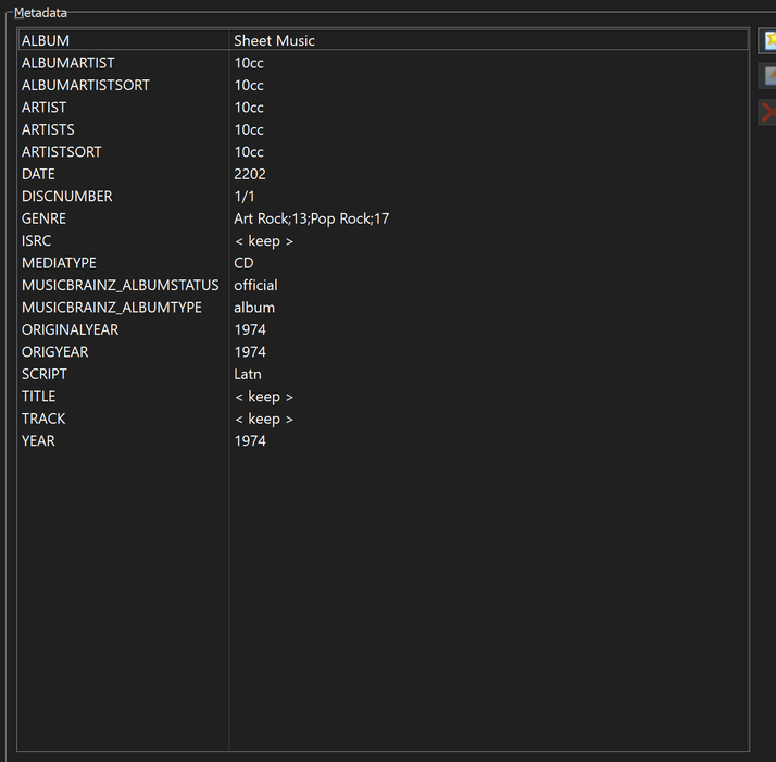

And this is the tags

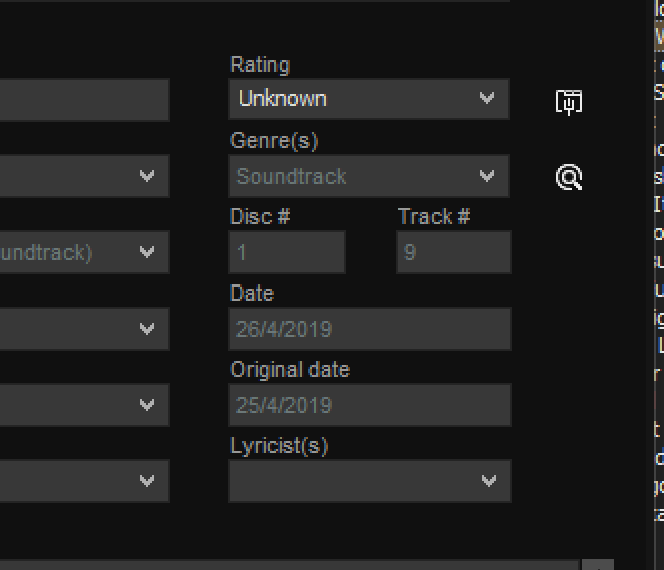

If your library is configured to use local tags/metadata, in MusicBrainz Picard, edit the tags for the album highlighted in this image. All of the tracks for an album must have the same data for the date fields, you can’t mix and match.
In MP3Tag, when viewing the “Extended Tags” for the album, edit these fields:
It works 100% of the time for me. You will probably have to refresh metadata for the new tags to show up.

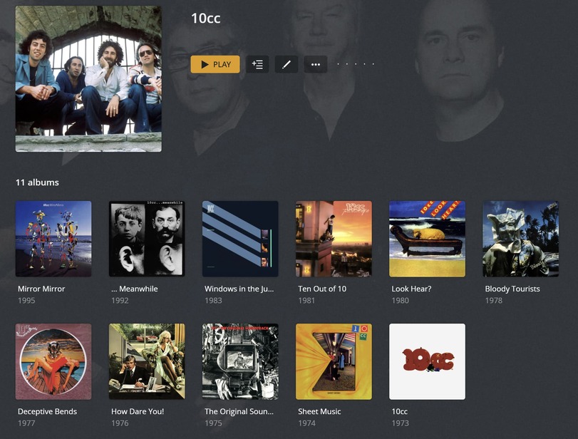

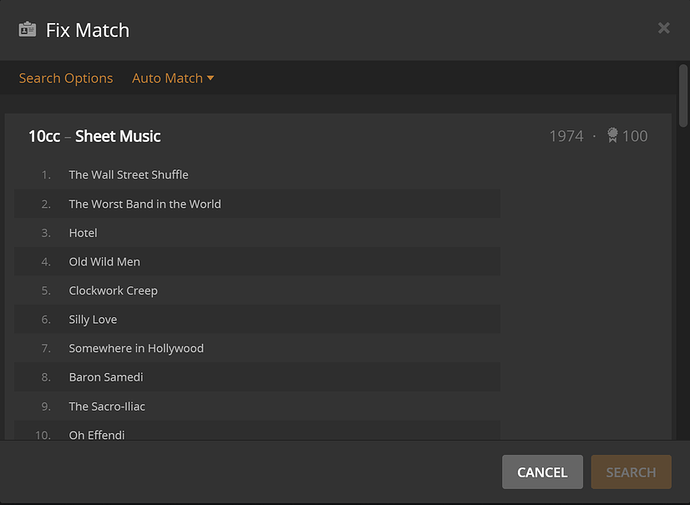

As to Plex and the year, still back to that issue. I have the year for both (as a test) set to 1974, and yet plex still shows the album as 1993, no matter what I do..
Even if I ‘fix match’ it refuses to change.

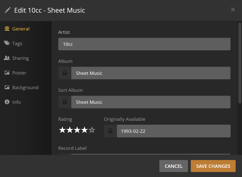

What’s odd, Plex says ‘originally available’ as 1993?
As you know, the date of any re-releases is not what I want, I want the date of my album release - originally.
And, I cannot manually change the year. lol
my tags look like this,
This is across all files.
I don’t think I have a “Date” tag in any of my files, but I may have configured MP3Tag to display the tag with a different name. Try removing that field. I also see that that date is 2202 - my calendar says that’s a few years away. :wink:
Change the the YEAR tag to what you want (in YYYY) format, change ORIGYEAR to something in the YYYY-MM-DD format. (I think you can just use YYYY too, but I’m not sure)

Anyway, for me, and regardless of what dates or years i put in, Plex will always look up the album and use the date returned from it’s matching regardless of me asking it to use my meta. I cannot find a solution to that at all?

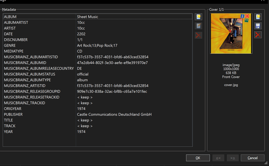

This it the latest meta test, and…
2022-03-21 17_01_54-Plex
Also, it may be picking this up as the German reissue due to the publisher/label being referenced. From Musicbrainz:
The “Label” here matches the publisher in your tags.
I was just checking the same.
Though, the main thing is, I am asking Plex to use my Meta when available, and all 3 Dates are set to 1974, yet it is ignoring my request and finding it’s own date and using that.
It looks like your album is matched to the German release as @pshanew suggested.

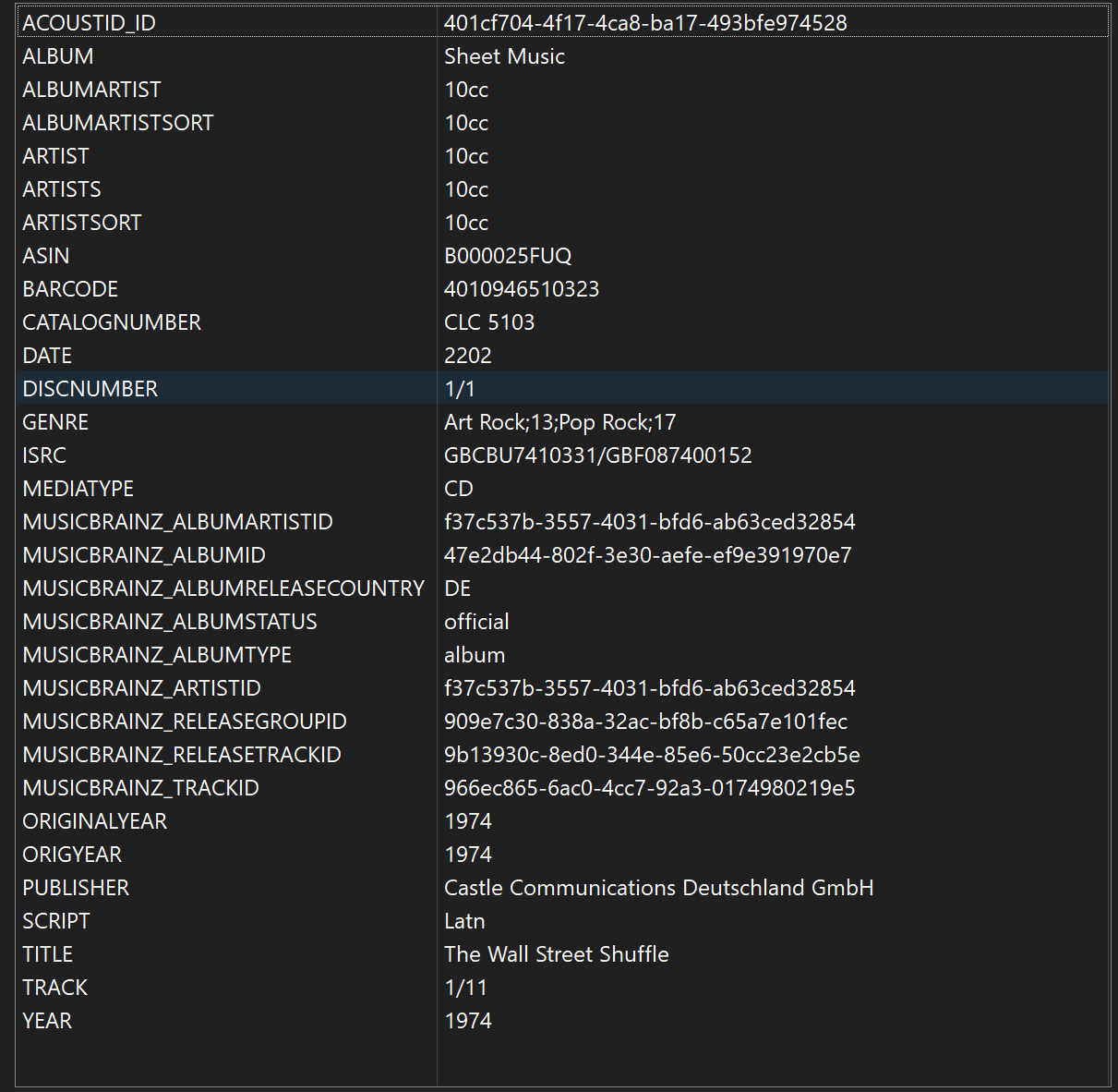

so, now removing all release info, music brainz markers, etc, and just leaving the year there for Plex.
Doing the Plex Dance again lol…
So, the only place to ask Plex to use my own meta is the tick-box in the Library settings? Just checking.
ok, stripped back all meta on the files -
Removed all from plex, rescanned, put back, rescanned, and…
I think I give up…
So, the year is there in triplicate, and yet Plex still insists in using it’s own.
