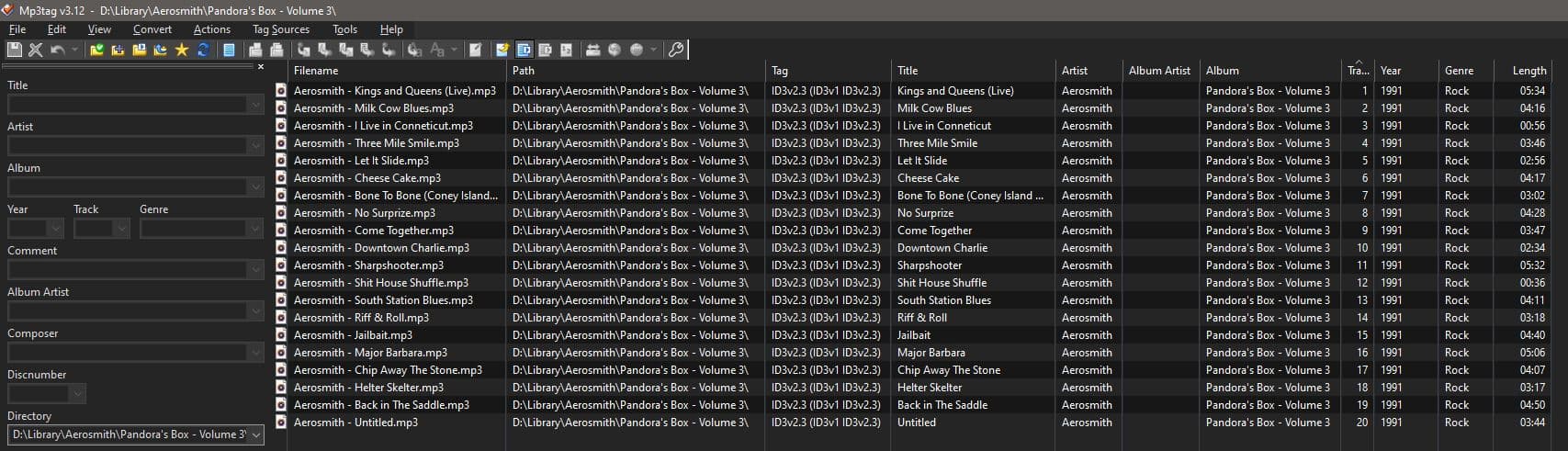

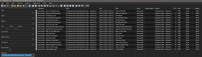

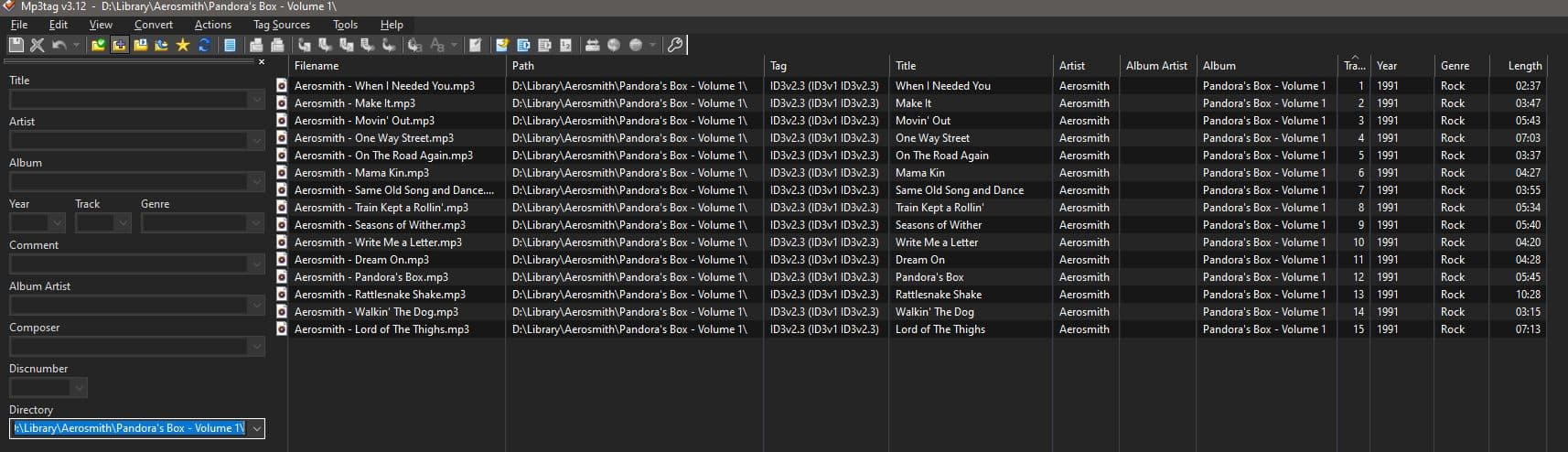

Not sure I’ve got this exactly right, but here goes…
Folder & Structure - D:\Library\Aerosmith\Pandora’s Box - Volume 3 (1 and 2 for the others)
The Embedded Meta Tags - See attached photos
Prefer Local Meta Tags - I’m struggling to locate this for some reason
The How-To article I linked to earlier explains where to find the “Prefer local metadata” option.
You know Ryan, I might try that. Maybe if it transfers to the Various Artists folder, when I change it back something might click. I have about 7 or 8 other icons (very large library) where EP’s and Singles line up under compilations or albums and other Live records that don’t line up under live either. I’m thinking once I discover the secret sauce here I can fix those as I happen upon them. I only recently kind of figured out that the mistakes (mostly capitalization and punctuation) I was seeing on my stereo computer screen where separate and apart from my actual library. I kept trying to fix things in my library that didn’t need it and wondering why it wasn’t translating to the visual when playing digital files through my stereo via Wi-Fi. I never liked the black and white band photos they assign to each artist so now I’m combing through a 4 TB library, one artist at a time, adding my own photos and fixing the mistakes mentioned above. I’ve been going at it since September 4th, maybe two hours a day and I’m only halfway through the B’s. It’s so worth it though; better artwork, zero mistakes, double checking categories, etc. I’ll probably finish around March at this rate, but I worry all of it will be lost if I change PCs or something else happens. I hope the saved changes are transferable! Thanks for trying to help me.
Issues:
  • each disc uses a different album title. Unify that to just “Pandora’s Box”.
  • there is no AlbumArtist set at all. Put “Aerosmith” in there.
  • You can use either a subfolder for the contents of each disc or put all tracks into the same album folder. But the latter requires you to prepend the track number with the disc number. Right now, you have each disc stored as if it was a wholly separate album, which it isn’t.
  • the screenshots don’t show whether a Disc # meta tag exists in the files and what it contains. In a multi-volume album it should certainly be present and it should contain the disc/volume number as a simple integer number.
