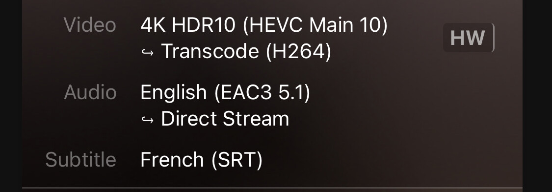

My 4K movie that was direct playing with srt subtitles suddenly has to transcode
Hello
Yet another issue with 4K and srt transcoding on LG WEBOS. Except that behavior changed in 1h timeframe and no change in my settings whatsoever.
Was watching a 4K HEVC vidéo direct playing from my Synology with Srt : direct play was working perfectly.
Made a pause in the middle of movie to get to eat. Stopped my projector. Started again 1h later and now, no way to direct play with srt files. Absolutely nothing changed, same network, same video, same server, same srt. But now it’s transcoding.
Any reason and solution to that?
Thanks a lot
Attached pictures with and without srt.

Hi, without subtitles it’s direct streaming. With subtitlers it’s transcoding and it says “ServerRender” for the subtitles decision.

The logging from the LG shows what happens.
Plex tries to direct play the video with French subtitles. The player has an error and switches to direct stream. This results in Plex transcoding the video, due to the previously mentioned limitations of the Plex LG app.
