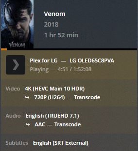

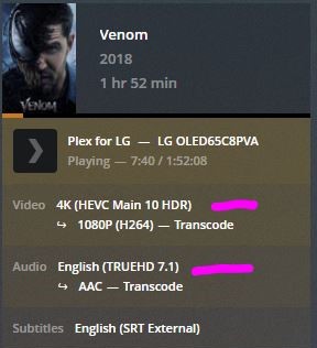

Any Movie I play that has SRT the video gets transcoded to 1080p and Picture losses Vivid color !!!
Same movie played with Xplay HDR and picture is perfect and not transcoded not even the sound but that is not the issue I know Xplay handle sound differently but PLEX team solve this issue this is really very awkward I found more than one person complaining about this and not feedback from plex team
after some testing I discovered that when selecting SRT subtitle this happens 4k is transcode to 1080p !!! what is this bizarre behaviors
even when I used option in plex app on LG settings video > burn subtitles for image formats or always !! still did not work 4k gets transcoded to 1080p !!! what is this
PS srt used in 1080p ok plex app Lg does not transcodes video so why does it need to transcode is 4K

I did the same thing in another file got different result now AC3 is transcoding audio and video 4k> 720p !!! what is this bizzare behavious the only diff is the AAC audio file is not the first Audio track !!! comeon !!

I also note that in both your screenshots the DTS track is being transcoded to AAC (and also the AC3 track). This should never be the case on an LG set like yours as it is capable of processing the DTS-HD MA track and passing the DTS core to your soundbar over ARC.
I think you need to make sure that:
  • your soundbar is connected to an ARC capable HDMI port on your TV
  • you’re using an HDMI 2.0 compatible cable
  • you’re connected to an ARC capable socket on your soundbar
…as it looks like the HDMI handshake is wonky.

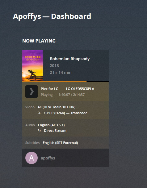

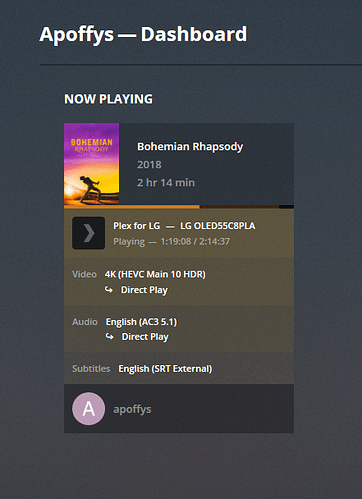

It happens every time on Plex client 3.88.0 on LG C8 here. I just tested, and it happened after roughly 20 minutes playback on a random point in the movie.
What you see in the pictures is what happens when it starts buffering, and it only happens when using subtitles. I’ll attach the logs as well. Playback started around 15.08.

edit: After reading the logs a bit more thoroughly, it looks like the client disconnected and reconnected to the server while playing, and then decided to use the first subtitle track instead of the selected track, which is an embedded PGS subtitle. PGS subtitles don’t support direct play, so it starts buffering.
That explains why it’s hard to reproduce and why it only happens some times. It only happens when the network is a bit spotty.
Nice spot! The client doesn’t seem to be resuming gracefully with the same settings as before the disconnect, does it? It obviously knows what file is being played, and where it was, but some of the state data is lost regarding audio and subs :thinking:
