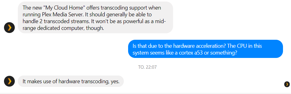

According to my chat conversation with plex on messenger this unit is useing hw transcoding.
The specs says the single drive unit transcodes 1080p, while the dual-drive unit transcodes 4k.

I would say it would be best to wait for someone to bite the bullet… For example, I have bought PR4100, it uses hw transcoding as well. BUT - the resulting stream is unacceptable in terms of quality when transcoding. 10 mbps stream has still artifacts and fuzzy blocks, it is unwatchable even on larger tablet. Be very careful. I would not buy ANYTHING that utilizes hw transcoding in Plex before seeing how the resulting transcoded stream looks like.
Welp, I bit the bullet on the My Cloud Home, same one the OP has judging by the model number, and hardware transcoding seems to be working okay, but I’m getting very frequent buffers… No clue as to why
