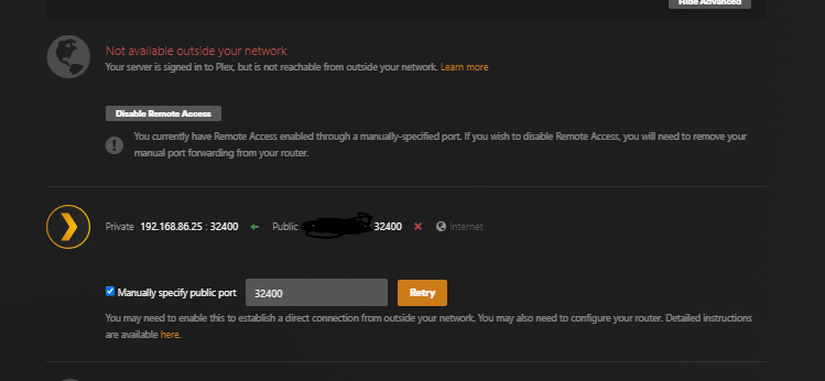

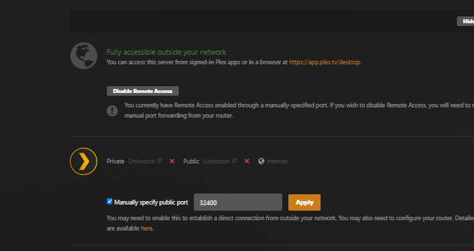

My server seems to report that it is offline but the GUI, for a few seconds, claims it is online
I don’t understand what is happening, my server has been online and working fine for years. I updated to the newer UI treatment version and now have loads of issues connecting remotely.
Settings > Remote Access will give me all green check marks for about 15 seconds, then shift to red. Even thought it shows red, I’m still able to get to the server but sometimes it says ‘no libraries available’ until I restart the server. There has been no changes to my router (Google Mesh/Wifi) my IP is static on my server and I have a port forwarding rule that has been working for ages with no issues.

Even with this image showing not available it IS available – but flaps online/offline

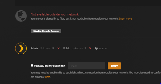

More flapping and odd behavior of the UI
After I hit ‘Retry’ I get this for 15 seconds

No. The initial green status is just an unfortunate design decision. It optimistically shows green before the actual connection test is performed. Once the latter has been done and failed, it turns red.
The takeaway is to simply disregard the remote status for the first few seconds.
