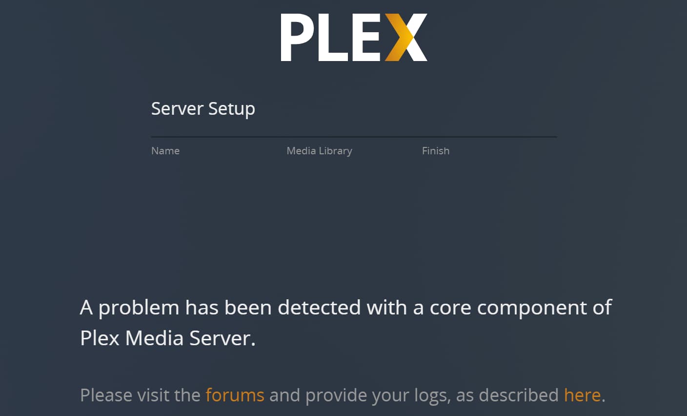

Total plex newb here, never had a working setup (which is why i cant find the exact server version easily, sorry); I’m running into this issue with access token
@ChuckPa - I followed your advise and am including my logs. Logs.tar.gz (27.9 KB)
The container starts fine and I am able to access the webUI to the setup page, but the setup page eventually gives an error that core plex services failed, which I could see from the docker logs (not included in the tarball)
Starting Plex Media Server.
[services.d] done.
Error starting framework core for /usr/lib/plexmediaserver/Resources/Plug-ins-c8bd13540/PlexMovieNew.bundle.
Error starting framework core for /usr/lib/plexmediaserver/Resources/Plug-ins-c8bd13540/TheMovieDB.bundle.
Error starting framework core for /usr/lib/plexmediaserver/Resources/Plug-ins-c8bd13540/LocalMedia.bundle.
Please let me know if any more info could be useful, and thanks in advance for any help!

Thanks for providing the logs with your post.
From looking at your logs, it appears you aren’t giving PMS enough time to complete its initial setup (create the directories, unzip the database, etc) before trying to access it.
In both your logs, you started it and stopped it within 1 minute.

You need to be more patient with it.
Your CPU (i5-3230M), which is 9 years old, isn’t that fast. It has somewhat less performance than most NAS CPUs now.
Recommend erasing the container contents (what’s under the /config directory),
Start the container again.
Wait 2-3 minutes for it to stabilize before accessing it
