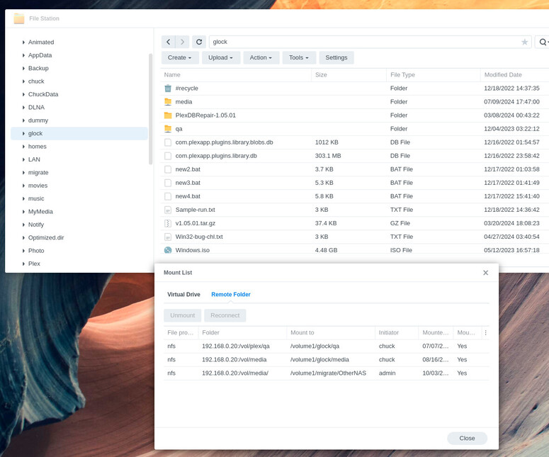

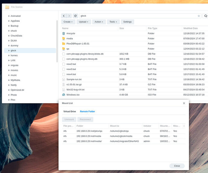

When I mentioned mounting, this is what I mean:
  1. Treat the NAS boxes like regular computers with folders shared between them
  2. One NAS has the bulk of the media
  3. One NAS has the rest
  4. Of the two, the best one runs PMS.
Here you see my little syno (development system)
pulling data from the big NAS (192.168.0.20)
