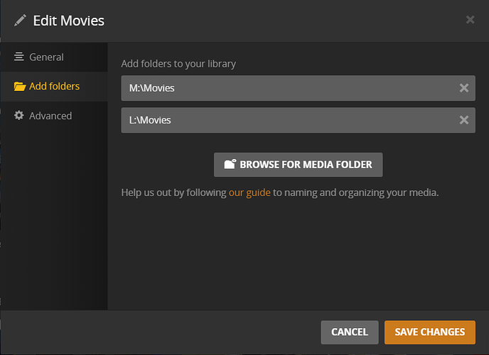

I understand that part…what I don’t understand is how to have Plex access 2 separate drives (NAS and external HDD). When I add a Movies Library I am able to point Plex to the NAS. I am not seeing anywhere that it gives me the option to add the movies library by pointing to the NAS AND the external HDD
To access another location, go to the ellipsis (…) next to movies and select edit and add folders. Browse for your external drive and directory as needed then save you’ll see something like:
YES YES YES! Just what I need. Perfect. I appreciate the help.
