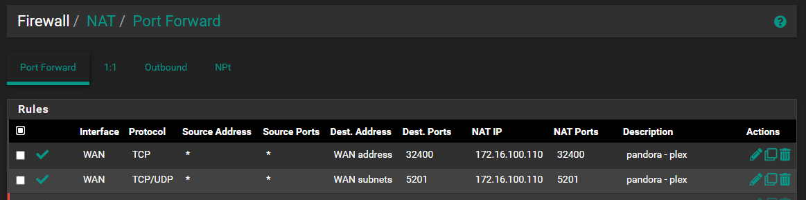

“… three levels of firewall here?..” → No. .just one… the pfsense.
– WAN/ → Fireawall table and filter rules based on unbound filter sets + other filters / rules
NAT —> router port forward. IF WAN from * proto TCP Port 32400 Forward LAN_VLAN100 IP 172.16.100.110 Proto TCP Port 32400

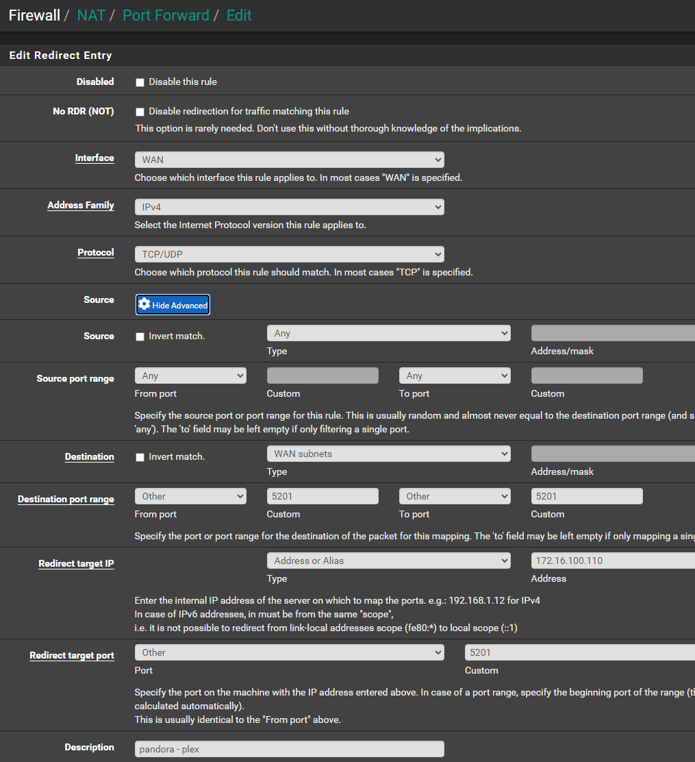

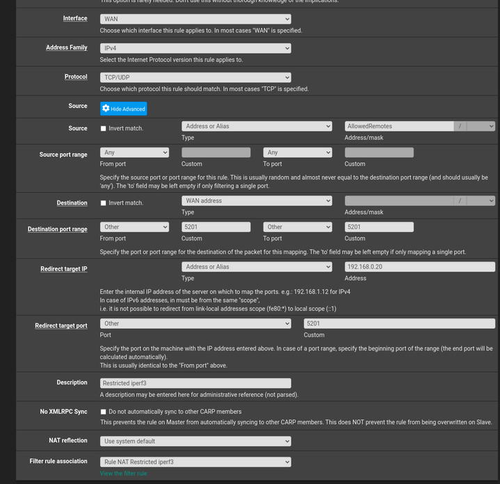

On pfsense, make a port forward rule to machine_IP:5201 TCP.
No restrictions, No VLAN tagging. Just a Pass rule to allow it into the WAN and out
Here’s mine.. which is restricted to specific source IPs (I don’t want to be an iperf server for the world). Machine IP is 192.168.0.20 (My NAS / PMS box )
Then put iperf3 on your phone / whatever and hit your WAN IP.
See what you get.
Go to the firewall logs and confirm Pfsense is passing in.
The firewall logs are visible in the GUI at Status > System Logs , on the Firewall tab.

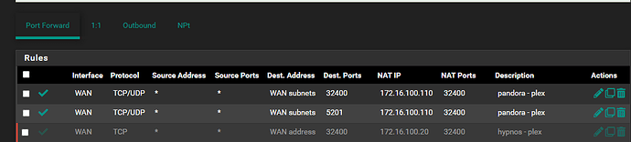

My PMS 172.16.100.110
NAT active rules
Intranet based test

and.. having built a baseline on tcp communication through to host on 5201.
Step 1: <stopped iperf3 listening service on PMS
Step 2: Update NAT to forward 5201 to host 32400
Step 3: Change listening port on PMS to 5201
Run Test… failing.
So .. unless there is some range PMS is happy with related to TCP port.. Change to 5201 as baseline shows something… is very likely within PMS.
Ok, so that works.
The rules match ? (iperf & PMS port forward )

What I am not clear in pfsense is:
  1. where to attach this “firewall aliases”
  2. How to know it overrides/ takes higher precedence over pfBlockerNG regional rules
Found it in : Fireall → pfBlockerNG → General Settings → Links “Firewall Aliases”
I think by just building the list it sets those targets within “allow”?
Not sure … but seems logical

With forwarding rule for 32400 set back to NAT to the PMS server … Remote check (aka VPN + SSH to remote host to connect through the internet).
[root@k8bastion ~]# **telnet 108-234-147-234.3f101blah49bf3bc44ca324e.plex.direct 32400**
Trying 108.234.147.234...
Connected to 108-234-147-234.3f101blah49bf3bc44ca324e..plex.direct.
Escape character is '^]'.
**GET /web/index.html**
HTTP/1.1 200 OK
X-Plex-Protocol: 1.0
Cache-Control: no-cache
Accept-Ranges: bytes
Connection: close
Content-Length: 12417
Content-Type: text/html
Date: Fri, 26 Jan 2024 12:18:37 GMT

IMAO: Above as noted shows:
  1. Internet forwarding through pfsense to PMS
  2. Session connection
  3. Plex is service on target 32400
  4. Concept of PMS registering its “hostname” within the plex registration service is working
