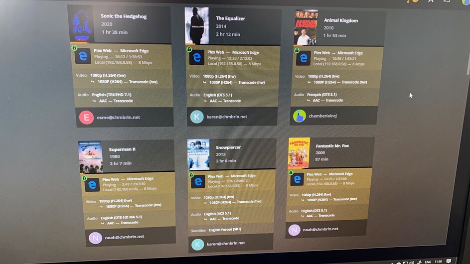

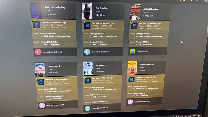

Quick one, I wondered what I could push the laptop (i7-6700HQ with an Intel 530 and Nvidia GTX 970M) to and I got 6 transcodes @ 8mbps (x264) going (all marked as hw which confused me):
CPU went 100% for a while when the 6th transcode started but then calmed down.
Is this expected with this hardware, is it effectively sharing the hw transcoding across the 2 GPUs in the laptop?
Plex defaults to GPU0 which is the Intel HD Graphics in this case.
You can see from your screenshots that you are closer to being CPU limited vs GPU limited, it might help you to understand that the audio being transcoded is the cause of the video transcoding in order to keep it all in sync. Unless this was a load test I would point out that there is a windows client (Plex for Mac/Windows) that not ask for stereo like the browser.
