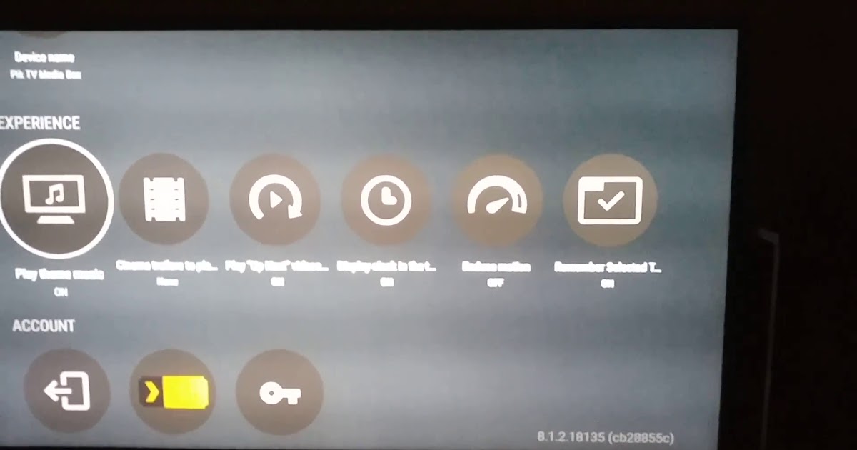

Once you’ve turned on network logging in the settings, you’ll see an IP address down the bottom right hand corner of the screen. It definitely appears when you turn it on (I used it yesterday). It should be something like http://10.0.10.21:32500/logging

I will capture a video later that specifically shows that the IP and port are not showing up on my Android TV box when selecting Network Logging.

Where is the IP address and port when turning on network monitoring?

In the guide for android logs it is written that the port for android tv is always 32500. The ip of your device can be seen in the router or the network settings of that android tv device.
Yes I know that. I was just pointing out that the instructions the Plex employee were giving were false. Also the logs don’t show. It’s says connection refused even though it has UPnP enabled.
