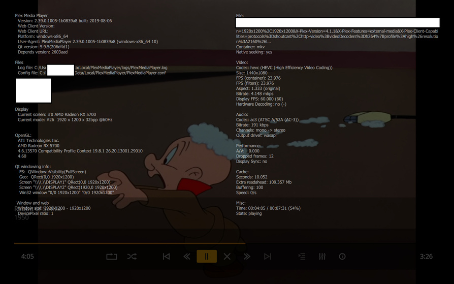

“Plex Classic” - Hardware Decoding disabled , Native OpenGL enabled

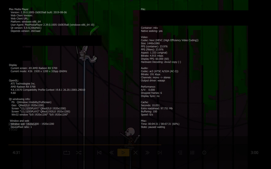

Reproducing the same issue in PMP

It looks like DXVA2 Copyback is the culprit? Is there a way to make “New Plex” use D3D11VA decoding like “Plex Classic” does without Native OpenGL?

I’m having the same issue with hardware decoding on 5700xt, running 20.4.2 drivers. Like the OP said, it appears dxva2-copy in mpv is the culprit. My own mpv setup runs fine, using D3D11VA, as well as Plex Media Player at time of writing.

AMD’s not entirely without blame, either their driver or the card itself doesn’t like DXVA2-CB with 10-bit HEVC. Except DXVA2 might as well be obsolete in and of itself, along with DirectShow!
I’d understand if it was the older PMP that was “stuck” using DXVA2, but you kind of have to go out of your way to force it to use it! “Plex Classic” defaults to D3D11VA. LAV’s decoder (example) defaults to D3D11VA. Even when I use an OpenGL renderer in another app (tone mapping HDR->SDR in VLC = D3D11VA decode, drawn using OpenGL output) I don’t end up with these artifacts.
