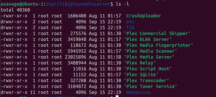

and installed it. The new (11Aug2025) files have been installed:
I rebooted. The new version appears to be the running version:
Relevant fragment is:
"/usr/lib/plexmediaserver/Plex Media Server"

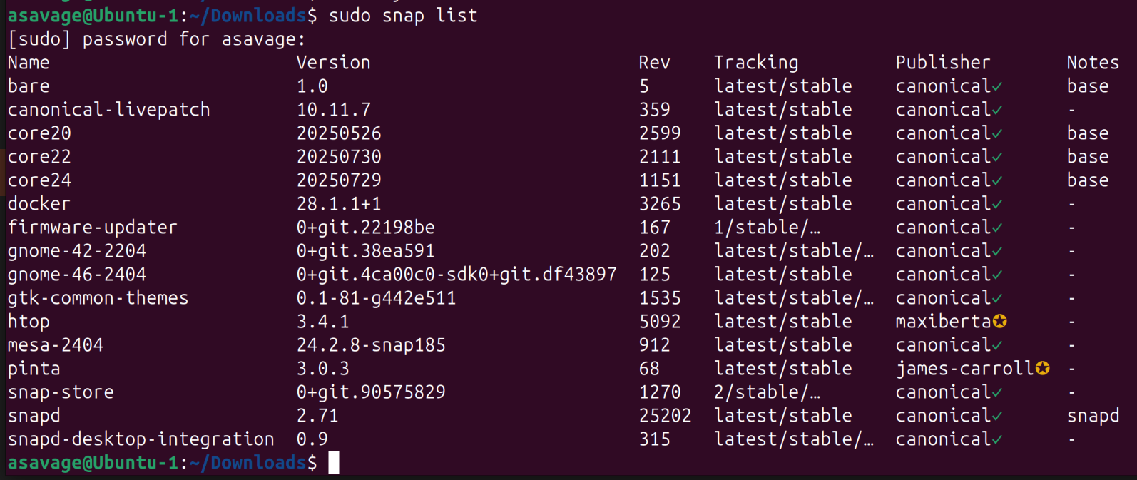

sudo snap list
does not show the snap version installed, so I didn’t accidentally instlal & run a snap version.

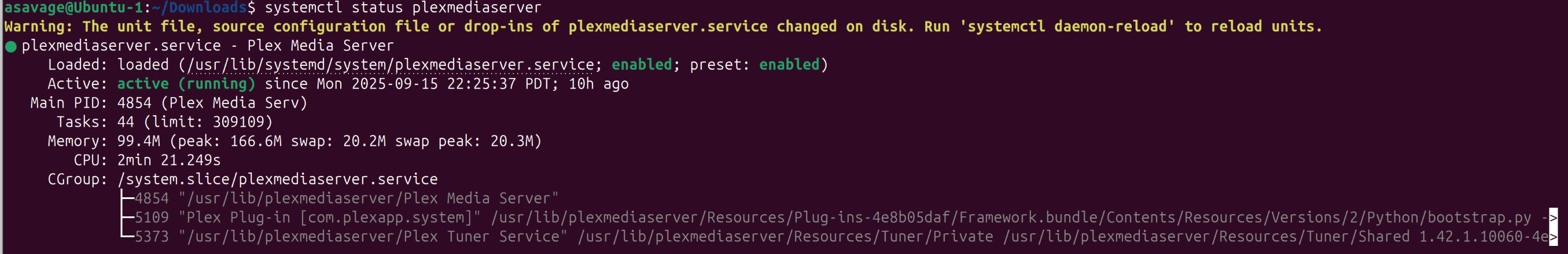

Warning: The unit file, source configuration file or drop-ins of plexmediaserver.service changed on disk. Run 'systemctl daemon-reload' to reload units.

asavage@Ubuntu-1:~/Downloads$ systemctl daemon-reload
Reload daemon failed: Method call timed out
asavage@Ubuntu-1:~/Downloads$ sudo systemctl daemon-reload

Did you create a /etc/systemd/system/plexmediaserver.service.d/override.conf file?
Systemctl is seeing that something changed either with /etc/systemd or /lib/systemd since it was last updated.
It’s alerting you to this.
( There are other places to check but first step is here)
This file does not exist in that location. I don’t recall working with any program or config files when I initially installed PMS a couple of years ago.
(shown above) I did run the command it suggested. Req’d sudo.
Just for anyone wondering: not in snap list:

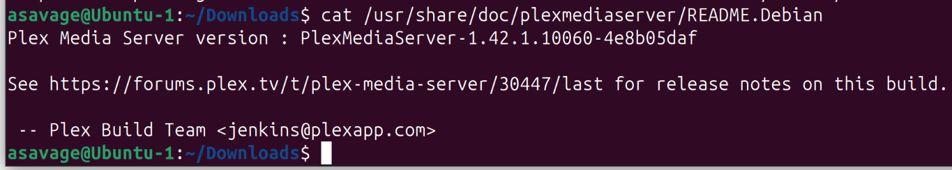

Please share the results of
[chuck@lizum plexmediaserver.2013]$ cat /usr/share/doc/plexmediaserver/README.Debian
Plex Media Server version : PlexMediaServer-1.42.1.10060-4e8b05daf
See https://forums.plex.tv/t/plex-media-server/30447/last for release notes on this build.
 -- Plex Build Team <jenkins@plexapp.com>
[chuck@lizum plexmediaserver.2014]$
Confirmed by:
[chuck@lizum plexmediaserver.2032]$
[chuck@lizum plexmediaserver.2032]$ dpkg -l | grep plexm
ii  plexmediaserver                               1.42.1.10060-4e8b05daf                   amd64        Plex organizes all of your personal media so you can easily access and enjoy it.
[chuck@lizum plexmediaserver.2033]$
