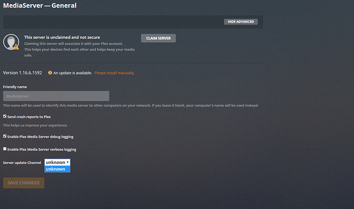

I just installed Plex Media Server on my Ubuntu server and I’m seeing a message in the general settings indicating that an update is available. I’ve tried downloading and installing the latest version manually, but it still says I need to update and when I try to claim my sever it just checks for updates again and nothing else happens.
Settings - Server - General ,
Put your Update channel setting to “Public”.
The only option available there is “unknown”.
Click “Show Advanced” (right side).
Notice on mine, I am using 1.16.4 which is behind the Public 1.16.6 so the update notification is correct.
Public update channel is at the bottom. If you aren’t seeing a choice of options where Public should be, Please download and attach the log files for me to look at. It sounds like something else isn’t working correctly

The only option listed on mine is “unknown”. I’ve attached my log files. Thanks for the assistance.
