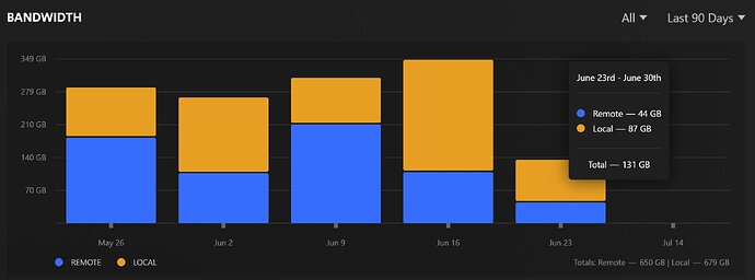

No bandwidth statistics stored

I’m also having the same issue. I’m hoping there’s some fix, I don’t fancy reverting my database back two months.

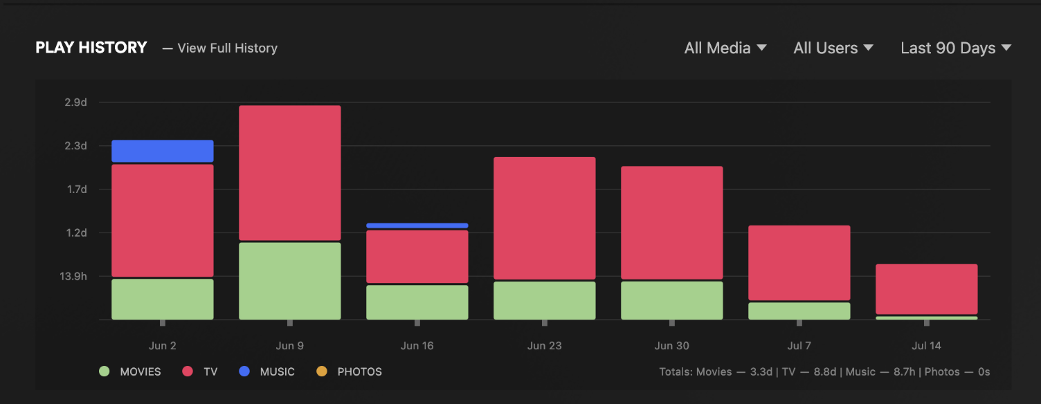

I’m also having this issue. At the same time this stopped, Plex DB borked a bunch of my “Recently added” shows and made them all show up again despite being added ages ago.
That update also seemed to break “Top users” and play stats. I can see the live view when a user is on, but now not recording any historic data. It’s now past the 30 day mark, only have it when viewing the “Last 90 days”.
What is interesting is that the “Top played” is showing data up to date:
But it looks like the actual data stopped some time in mid-July. I remember this was the same time as the PMS 1.41.9.9961 version.
I’d rather not have to re-do the database here. Happy to send logs as needed.
DB Repair says everything is dandy:
