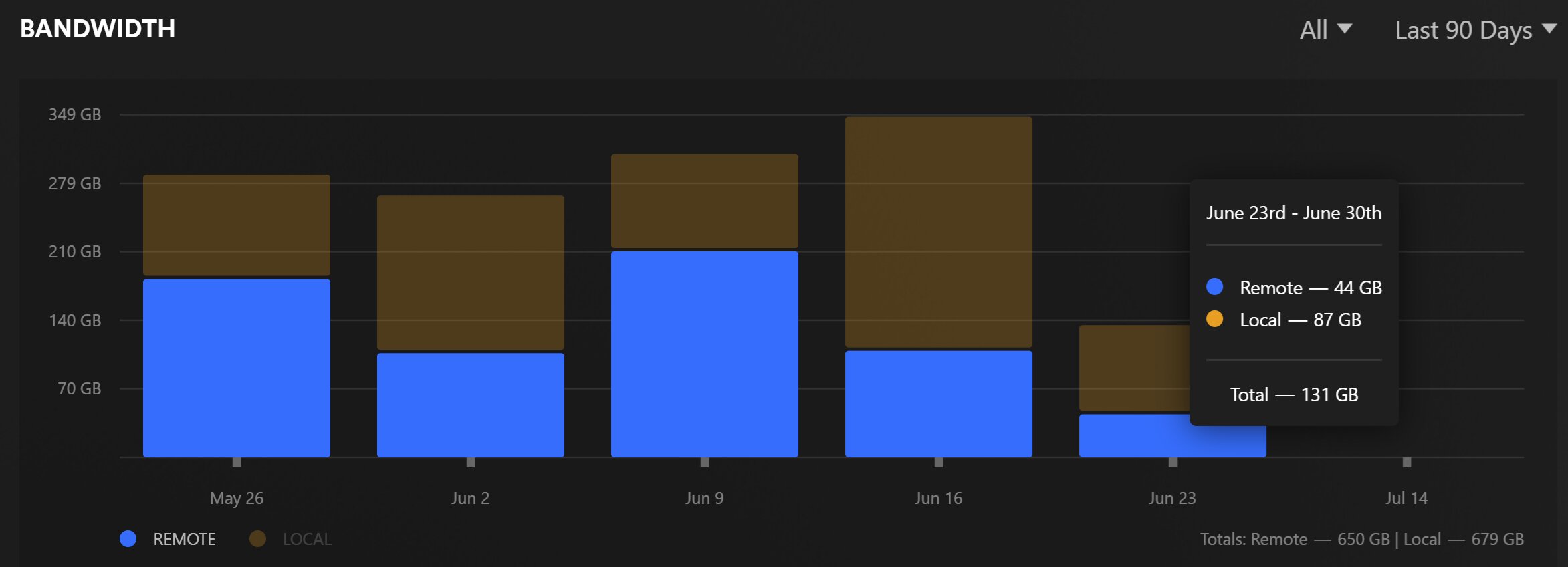

I’ve just noticed that I am experiencing this as well….
It would appear that Plex has stopped recording since I last ran the PlexDBRepair batch file on my database files on the 29th June 2025.
Real time bandwidth monitoring works just fine, however no stored history after that point.

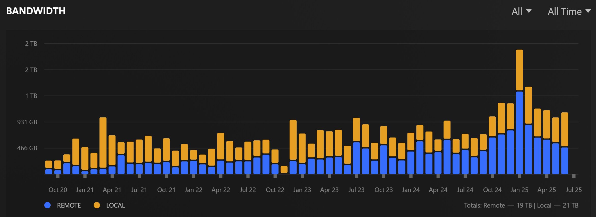

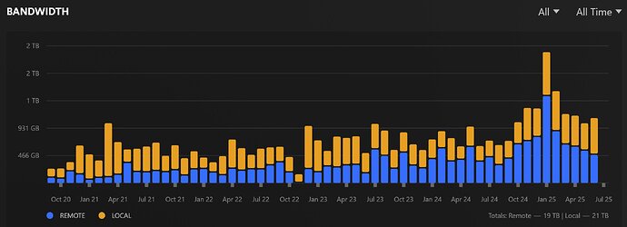

@ChuckPa - Just read your last post… If I had a missing table, wouldn’t that imply that I would absolutely no historic statistics data at all?
In theory, on the basis that I still have all historic statistics data prior to the 29th June, that must imply that the table is still there but the app is no longer updating it.
Historic bandwidth statistics dating back to September 2020…
