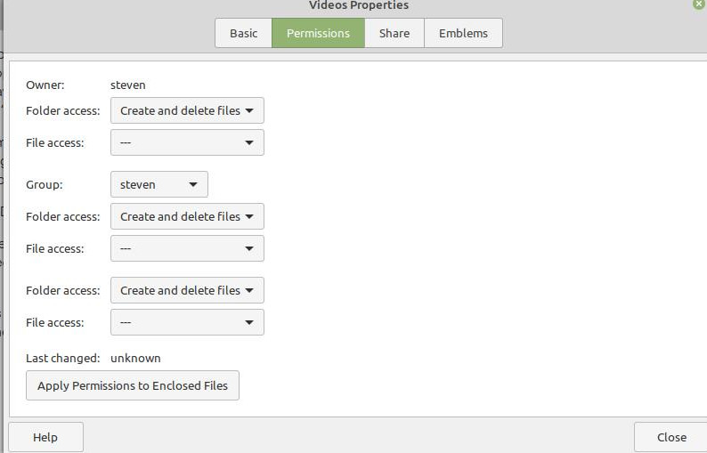

all the files and folders have create & read permissions. see the screenshot here.

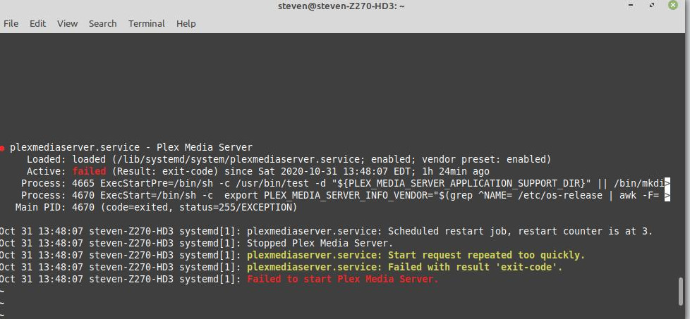

Also i double checked the status of my plex media server and it says it failed to start.
What you are showing me is a failure of PMS to actually start.
This has nothing to do with media at this point. Right now, the server hasn’t started.
  1. Did you modify /lib/systemd/system/plexmediaserver.service ? Your screenshot showing your username implies you have made changes.
  2. If so, show me what you did and do you know there is a proper (Linux supported) method for making those changes?
The error implies that /var/lib/plexmediaserver/Library/Application Support doesn’t exist and cannot be properly initialized in the startup sequence.
I need to know more about this path. Was it moved with Symbolic links or by other means?
