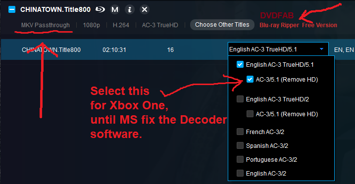

Microsoft is pretty lame as it’s just a software issue,
you have to degrade and add to no hd audio
[add no-hd sound track]
