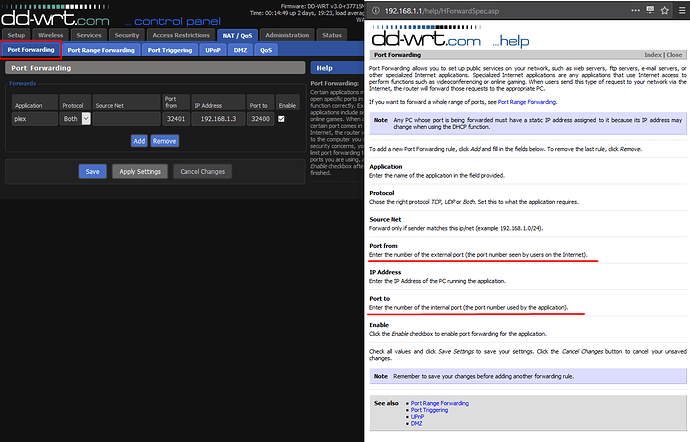

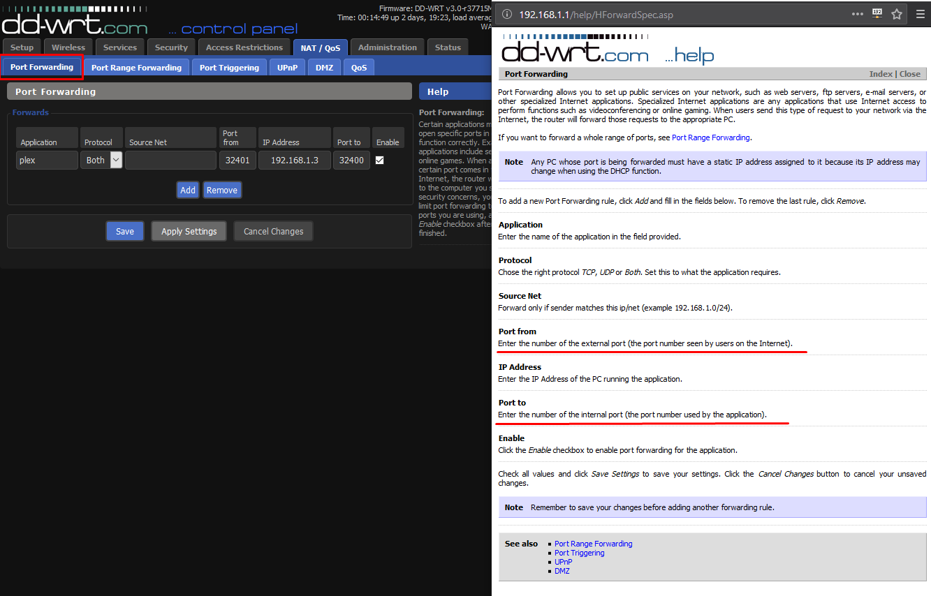

The only evidence i have seen of a screenshot from a router Port Forward Range screen which looked wrong to me as it appeared to be forwarding to 32401 and not to 32400
If you are expecting manually specify port to automatically do a uPnP port forward for you then you have misunderstood the functionality - automatic port forward using uPnP is only done when Manually Specify Port is not selected
Why would I want to open up 34200 which is for lan, and would the default target for attackers to find open security issues by plex. I want to manually assign port, The manually mapping must be broken or else I need some guidance, because all other services I run and port forward just works?, like teamspeak,csgo servers, when I remove them from the port range the ports are closed ?
When I add default port 32400 to manually assign in plex and the router it works, but when I replace 32400 to 32401 in any router I tested it does not work, I’m telling plex manually port service page is broken, its like it never reaches the router, and says hey im open, but plex does not transmit the info to the routers, is there a delay from adding manually port that is NOT 32400 to plex dns/services before it gets accepted?
Normally you do not have to and you configure your router port forward rule to forward a different public port to local port 32400. eg forwarding 32401 to 32400
But … the screenshot you provided me indicates to me that the router has no such capability for the firmware that you have running on it - allowing you only to specify the port range and not giving you the option to have a different range for WAN/Public and LAN/Private
May be there is an advanced port forwarding rule setup page that would allow you to do what you need
What is important that the port forward ends up on 32400 when it reaches 192.168.1.3
SORRY its me being a ignorant stupid d!ck
I totally missed the wan port to lan port internally even tho it was mentioned several times.
I have fixed it and its shown in DD-WRT here
what can i say - i did ask you to switch to Port Forwarding page instead of Port Range Forwarding
and as you i repeatedly referred to wan/public and lan/private ports
