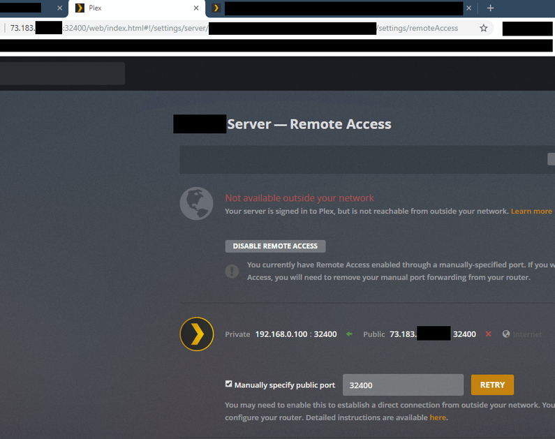

Remote Access totally broken, but I can access remotely using my IP
Server Version#: 1.14.1.5487
Player Version#: 3.77.4
Running on Windows Server 2016
Plex.tv refuses to connect clients to my server. This worked fine until recent releases of Plex, and nothing changed on my network.
As you can see, Plex insists that my server isn’t accessible from my WAN IP, but you can also see that that’ exactly how I’m accessing it (connecting via WAN IP from work):
Port 32400 is manually forwarded to my server, which is using a static IP. Clearly it works, since I can access the server remotely, just not though Plex.tv.
Remote Access keeps disabling itself. When I re-enable it, it goes green for a second, then goes back to red, and no one can connect directly to my server anymore.
Please advise.

I have restarted, and verified at canyourseeme.org - I don’t care if its red or green, I care that it actually doesn’t work when you access app.plex.tv, since that’s what users do…
I also reset my router, for good measure.
At best, some users, sometimes, get an indirect connection.
You can see in my image that the port is clearly open, since that’s how I’m accessing the server directly, remotely.

The thing is, when I see it failing (and only offering people indirect connections), I can access Plex via my WAN-IP:port from outside my LAN, so I know it’s open. I used a third party web port checker too, which verified this.
