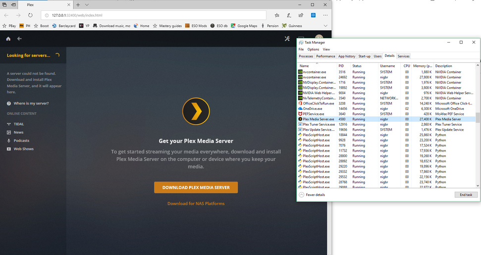

All I get by visiting the site you posted is a continuously spinning disc next to the words “Looking For Server”

I have just visited plextv web site signed in and then downloaded the plex server. still no server found. I have taken a screen shot of the looking for server and task manager
and this is if I right click on the plex icon and ‘open Plex’
Your plexscripthost.exe is insane.
My guess is that you accidentally signed your PMS into another Plex account.
There are Plex setting that don’t get removed by just installing PMS. You can try a full uninstall by following this https://support.plex.tv/articles/201941078-uninstall-plex-media-server/.
Or do a strategic strike and just remove the account information, https://support.plex.tv/articles/204281528-why-am-i-locked-out-of-server-settings-and-how-do-i-get-in/.
