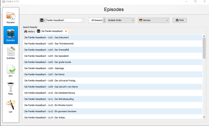

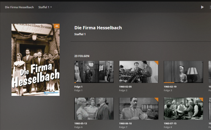

I have 2 DVD Series named with Filebot. One is shown correct with the names of the episode.
The other episodes are named with a date.
Can not find a difference between settings, but i can find the solotion how to get them named correct.

Thank for checking this out. If i click EPISODES in Filebot, they are named.
But.. it does not work. Named them manually now.
