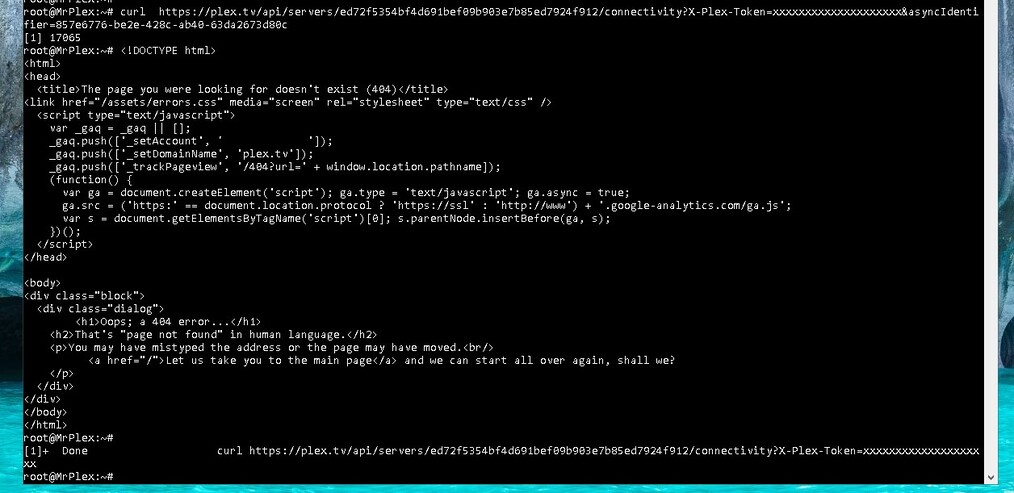

Curl to the url in the warn message
"root@MrPlex:~# curl https://plex.tv/api/servers/ed72f5354bf4d691bef09b903e7b85ed7924f912/connectivity?X-Plex-Token=xxxxxxxxxxxxxxxxxxxx&asyncIdentifier=857e6776-be2e-428c-ab40-63da2673d80c
[1] 17065
root@MrPlex:~#
