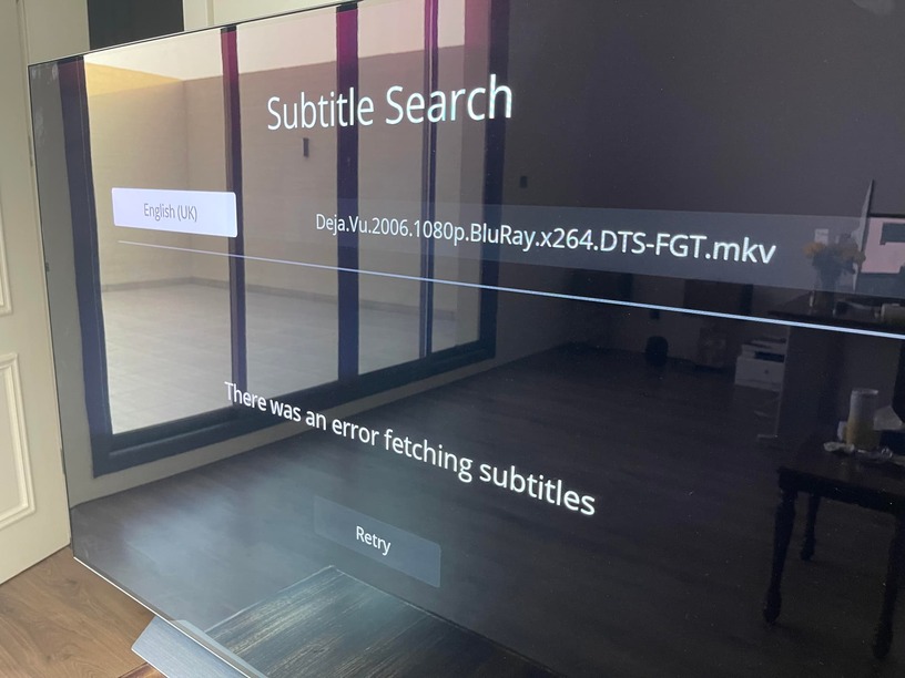

I have installed Plex Media Server on Windows 10 and am a Plex pass member. I’m trying to have an auto-subtitle for all movies in my library. I created an account on both sources:
I have tried the built-in feature via opensubtitles.org and whenever I want to browse additional subtitles (Search for More…) it gives me an error (There was an error fetching subtitles)

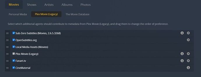

Then, I installed Sub-Zero plugin and did all configurations and I got the same results.

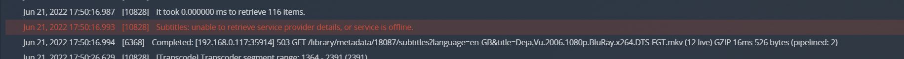

I enabled the debugging to get more information, and I found the below message on Console logs whenever I want to search for a subtitle:
Subtitles: unable to retrieve service provider details, or service is offline

When Plex dropped plugins and rewrote the Movie and TV scanners we lost support for both options.
I think I read that they are working on an opensubtitles replacement, till then Bazarr is the recommendation.
