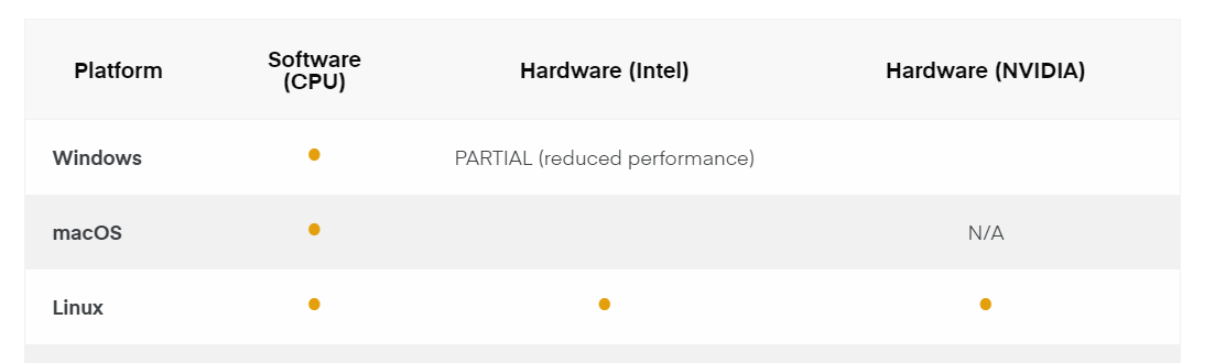

Happy as I was, upon testing, my CPU tanked and GPU was sitting idle without a lick of care :slight_smile: Naturally, I go digging in the docs to find a very informative support matrix:
I’m in the unfortunate (for this case) camp of Windows, and would like to know :
When will tone mapping on NVIDIA hardware be supported?
On that note, can anyone confirm the linux implementation is successfully offloading to GPU? I’m sitting on a conservative 3770k, Quadro p2000, windows implementation box, and would greatly benefit from proper Windows support :slight_smile:

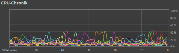

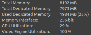

Since I saw that Linux should support this properly, I finished one partition with Ubuntu 20.10, done all updates, installed Nvidia drivers and set up Plex.
It behaves a lot better here. ~10% CPU utilization, up to 30% 3D utilization an up to 100% video engine utilization. The GPU load then fluctuates between full load and “idle”.

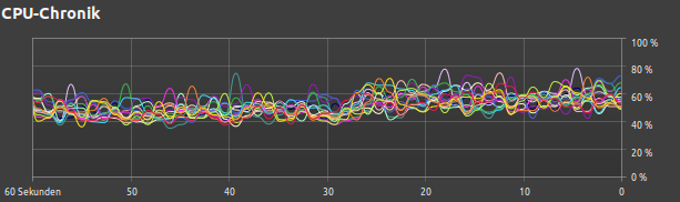

Oh, here’s the load under Ubuntu when I transcode there with the CPU.
(the tonemapping picture is the same as in Windows with CPU)
~60% CPU utilization and up to 40% 3D utilization, 0% video engine utilization
1609011945247
1609011993218
Since Trancode’s CPU utilization is abnormally high, I would advise anyone against it. We are talking about an 8 core / 16 thread CPU that is well utilized and needs to be cooled accordingly. In addition, the picture via the CPU is worse.
