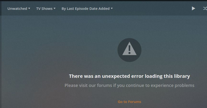

I am running Plex server 1.9.7.4460 on a Synology DS412+. The server has three libraries: Movies, TV Shows and Music. All are functioning fine with one very strange and very specific issue that I’ve identified. If I click on TV Shows library and then choose “Unwatched” > “TV Shows” > “By Last Episode Date Added”, I always end up with “There was an unexpected error loading this library”. If I change from Unwatched to something else, or if I change the sorting to “Date Added”, for instance, or any other field, then I get the correct results shown.
The screenshot below shows the filters that cause the error. I have enabled the debug log and looked at what is a huge myriad of json output but I don’t see anything that is an obvious error and only status:200 responses, etc. It’s a particularly noisy log. Some idea of what specifically to look for would be helpful.

Thanks Otto. I tried the db optimize. It didn’t fix the issue. I’ll set about the continued steps this evening.
I ran into a seemingly unrelated issue that has my plex completely broken. I ended up uninstalling and reinstalling it (a newer version, as it happens). The new install fixed the short term issue that had cropped up but on this fresh install (same DB) I still have the same issue in the OP.
I have had some time to do more testing. Optimising database had no effect. As a matter of fact, I’ve now been through a few fresh installations of Plex and the issue persists across freshly built installs. I have used the official Synology DSM package as well as Plex through a Docker container (which is what I am on now) and both had the same result.
I’ve looked at the logs and although I am no wizard at this, I am guessing the SLOW QUERY messages are going to be the issue. I have included two log snippets. In both logs, I started recording just before selecting the filter criteria which causes the error. In the first log, I was playing music simultaneously. The message occuring before the pause in the timestamps lead me to do a test without anything playing and I still had the same experience at the browser.

I should also mention that if I use my Android phone, the plex app shows me the requested criteria without an error.
The server runs very snappy and I don’t believe that, in general, performance is actually going to be the issue here. Other page loads are all great and responsive and my other device does load this set of options correctly.
I did set the Plex container to high CPU priority and assigned a full 1024GB of ram (on a 2GB nas doing little else) to make sure it has loads of resources. At present, the machine is doing almost nothing with a total system usage of 42% memory and CPU usage floating in the low single digits. The disks and volume are seeing almost not utilization and Plex is running directly on the NAS so the library files are local and not being loaded over network.

For interest’s sake, I’ve recorded a quick webm of my plex shows being navigated briefly. I flipped through a dozen or so filters and you can see that every selection responds very snappy and quickly until I hit the one aforementioned filter and it just stops dead and eventually times out. I’m a software developer myself and am pretty sure this isn’t a throw-resources-at-it problem, this is something specific with this query, whether it’s just horribly optimized or something else, it should be fixable because there’s no reason a machine that can handle the rest of those requests so easily could reasonably be expected to just be unable to perform another basic query that, at most, adds another level of joining to the lookup.
