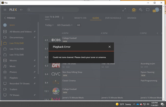

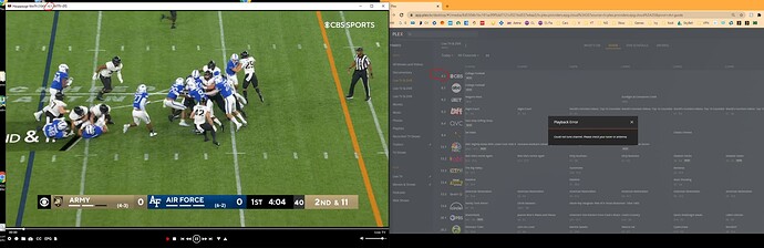

Hey Guys, Running plex svr 1.24.5.5173 currently. Been fighting what I thought was an antenna or tuner problem where plex is not playing live OTA channels properly. Recorded TV does playback works properly for the most part. Tried swapping and doubling up with antennas. Then switched from a 2 channel Hauppauge internal card to a plex approved WinTV Quad HD USB - no improvement. Using the Hauppauge WinTV 10 app to test playback looks to work great per the image below (error in image is ‘Could not tune channel. Please check your tuner or antenna’) and plex live tv tests fail using chrome on my server or a Win10 Plex app that has been more reliable. Has anyone else run into this and found a solution? Thanks

A look at the error on a different windows machine and windows plex app. All Wintv apps confirmed closed on the server including an IR program in the system tray

Hey Moviewiz, I just killed the HauppaugeTVserver service and retried - no good per the error in the image. Thank you for the suggestion and I welcome more.
