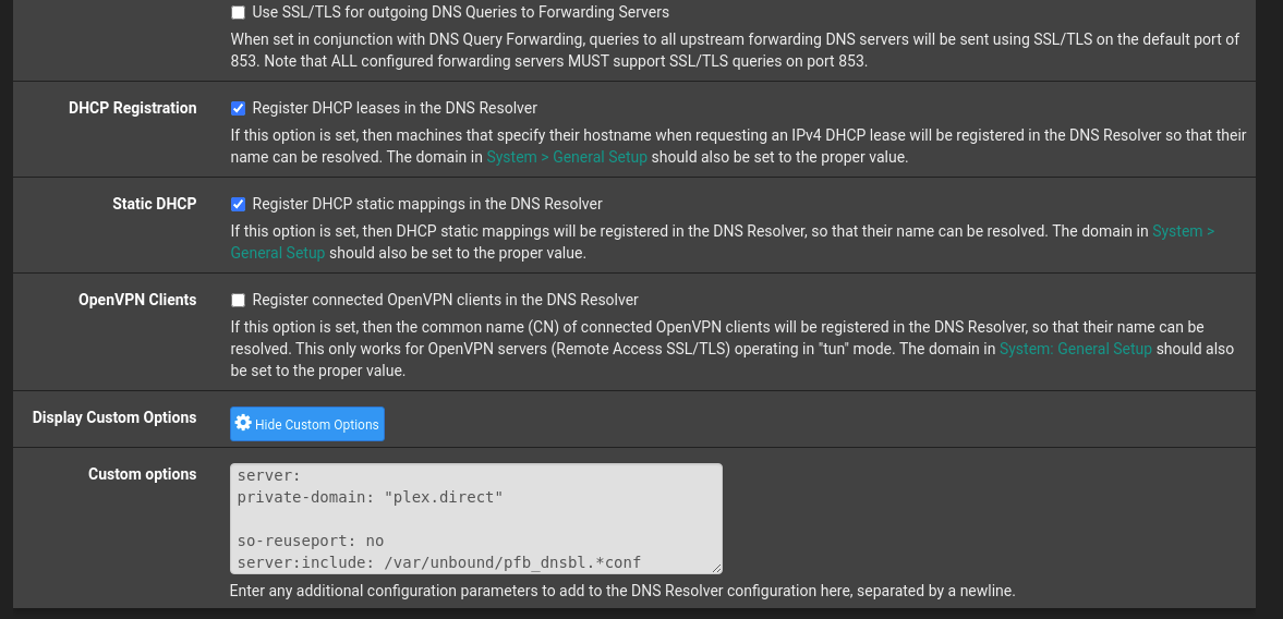

  • DNS Resolver IS enabled
    • custom options: server: private-domain: “plex.direct”
