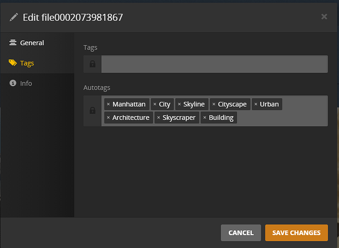

Autotags are meant to be used to improve search and add context for related items in hubs so they aren’t really very apparent in the UI until you specifically use those operations.
One place these tags will show up is in the edit screen for the items (as long as you’re on PMS version >= 1.12.0). If you click the pencil icon on the item and then navigate to the “Tags” section you’ll see Autotags listed there like this:
If you see nothing here there are generally a few causes which are most obvious:
  1. The autotagging algorithm was unable to detect the objects in the photo with a high enough confidence.
  2. The service is unavailable due to your account being throttled (you need to have tagged quite a few items recently for this to happen).
  3. There was another photo library busy tagging items before creating the new library and your new items are in the back of the queue.
If you’re still having issues please provide your logs and I can take a look to see what’s going wrong.

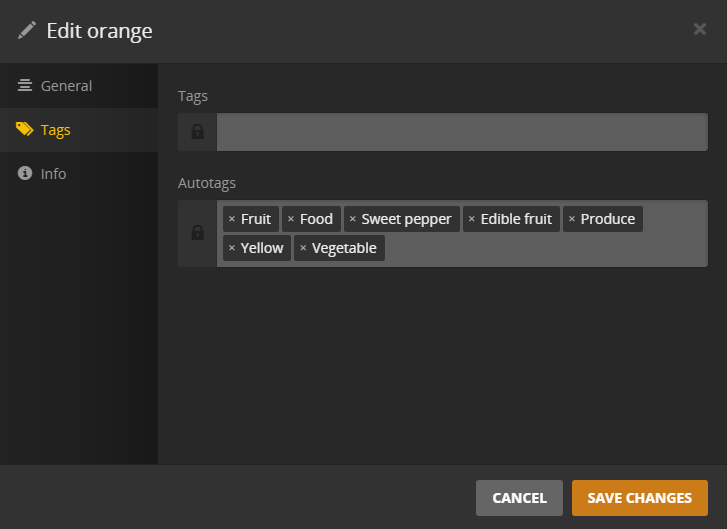

I have just got a Server update to version 1.12.0.4829 and also a Windows Plex media player update, and it seems the Tagging started to work. While I still don’t have the small tag icon in the upper right corner of the picture if I’m editing the pictures then now I have the TAG option visible and I can see the Tags if I’m searching for the tags then it finds the related picture.
