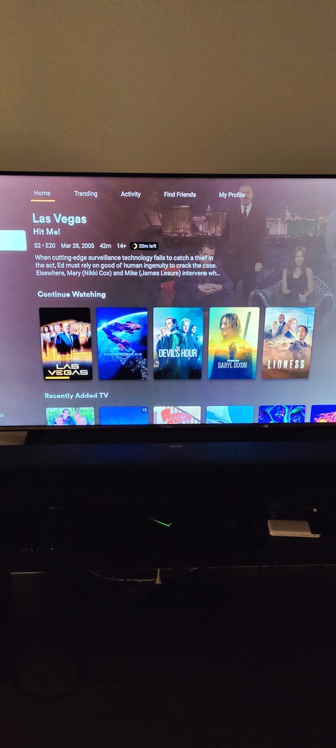

No Play Next displayed
This is what “should” be showing in Play Next

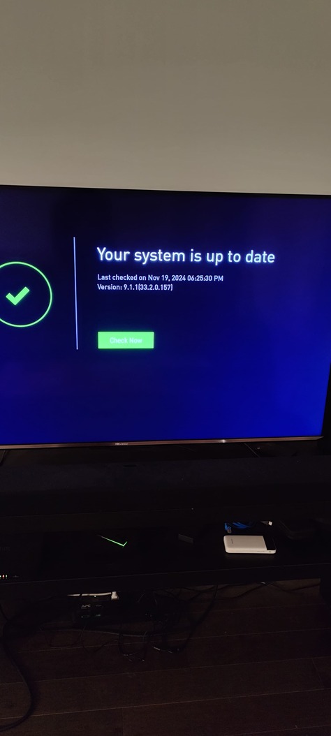

Firmware up-to-date
