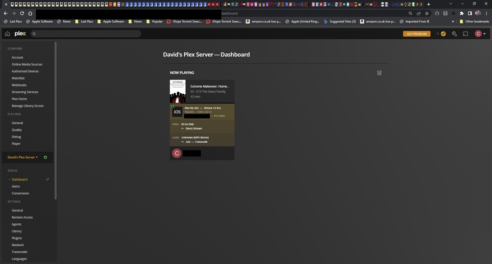

When you do that, can you pull up a browser window, login as the admin account (if you aren’t already), then take a screenshot of the dashboard there while you are streaming a movie from your home computer. We can tell a lot from the details here so we don’t have to ask 20 questions. Make sure to expand the details by clicking that fat hamburger icon to the far right.
Also, a speedtest result (or the advertised speed of your ISP) at both locations. I am thinking it might be a bamdwidth issue (not enough upload at home, or not enough download at the parents’ place).
Here is a screenshot of my dashboard:

That’s a head scratcher. The vid’s SD resolution, and less than 1 Mbps. The audio track is transcoding (strange), but none of that should cause the issue of video freezing and audio playing. Especially if the same vid works fine locally, but not remotely.
I’m stumped.
