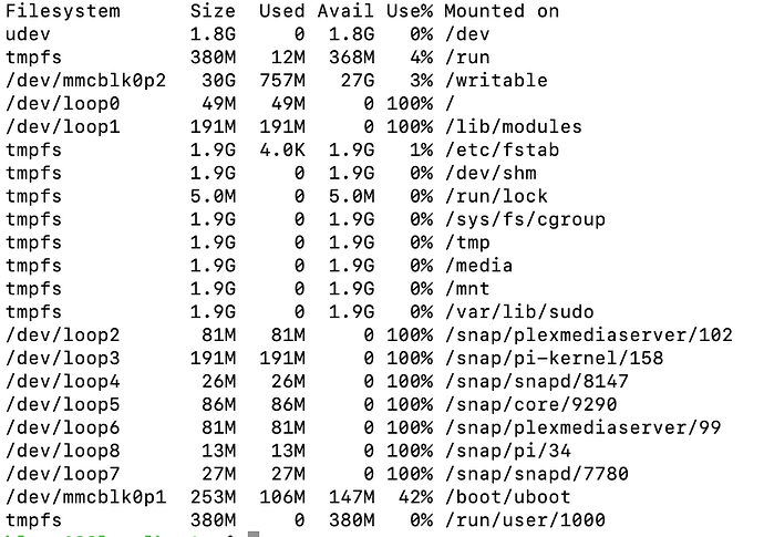

The df command shows me this. I’m not seeing it listed here. It should be showing up as a 640G drive. Could this mean it’s not mounting at all?
That does appear to be the case. Disconnect the drive and then reconnect it. Then run dmesg | grep sd[a-d] to see what the last few lines of output are, if any. Hopefully you’ll get something like this:
In this case, sdb is my drive, and sdb1 is the single partition on it. If you do see something similar, you can use that information to create the manual mount configuration. If you don’t, then the system isn’t seeing the drive at all for some reason.
