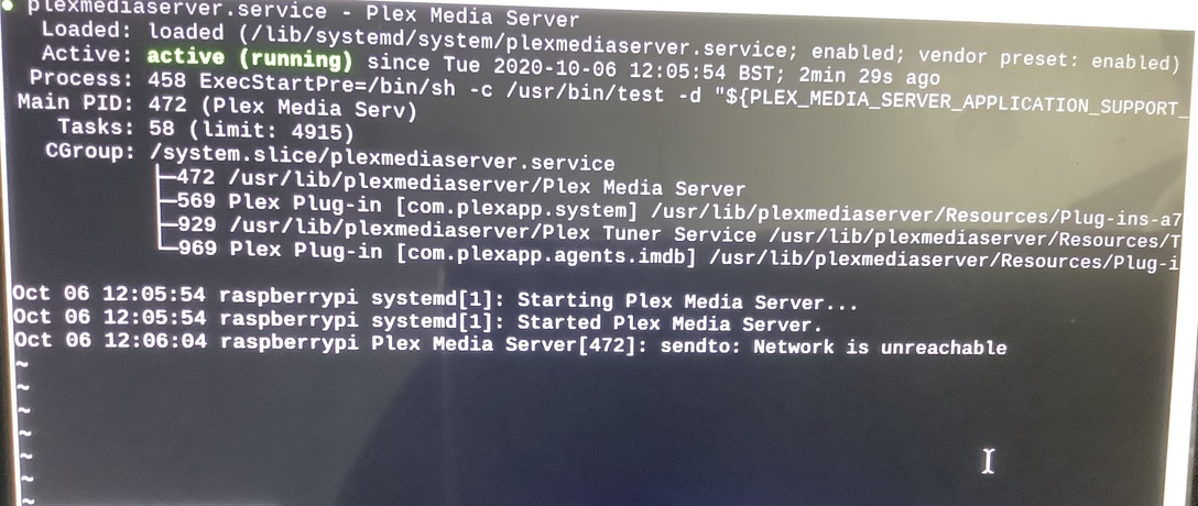

(2) Do you use the default PMS setup with Linux user plex? Please post the output of systemctl status plexmediaserver to make sure you do not have a systemd drop-in, e.g. “override.conf”, in place. If you have, please post the contents of your “override.conf”.

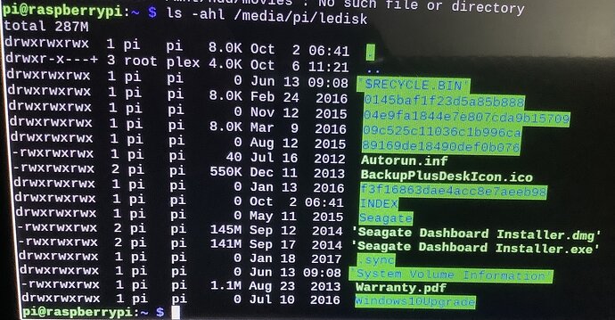

(3) Please post the output of the Linux permissions of your media directory you are not able access. e.g.: ls -ahl /mnt/hdd/movies. We do only require the first lines, i.e. the permissions of the directory itself and at least one media item.
Yes sudo apt install ntfs-3g was attempted. It has now been installed again as per your request.
Yes, it is set to the default. active (running) No “override.conf” anywhere. Listing ends with Network is unreachable and then several ~
A photo of the third request is attached.

Here’s the photo for the second request. Sorry for the mixup.

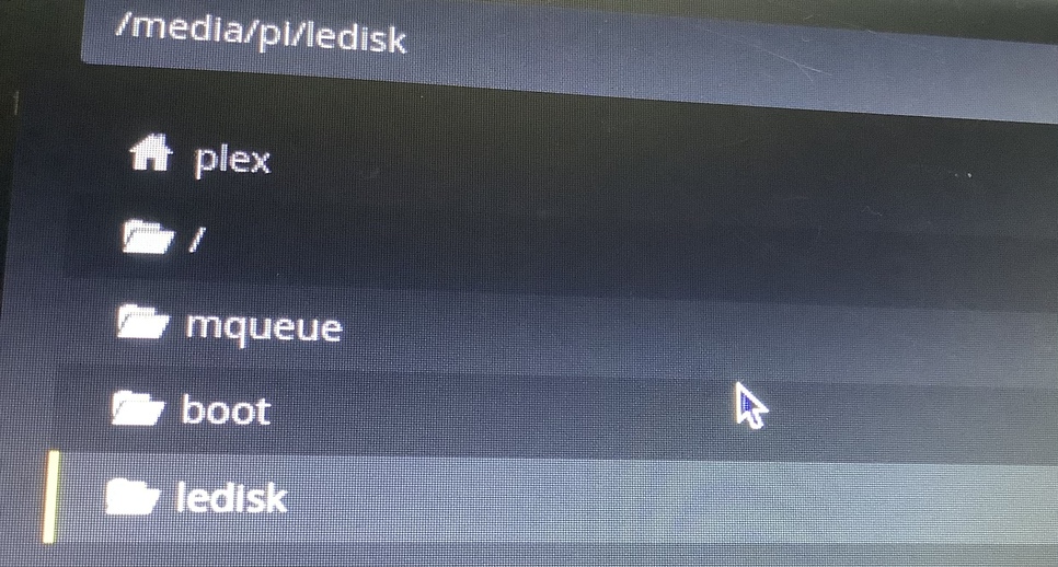

Thank you. Can you now please show us the same output for the directory that is still “empty” in Plex? Or is even /media/pi/ledisk empty when you try to create a new library?
Here you are.

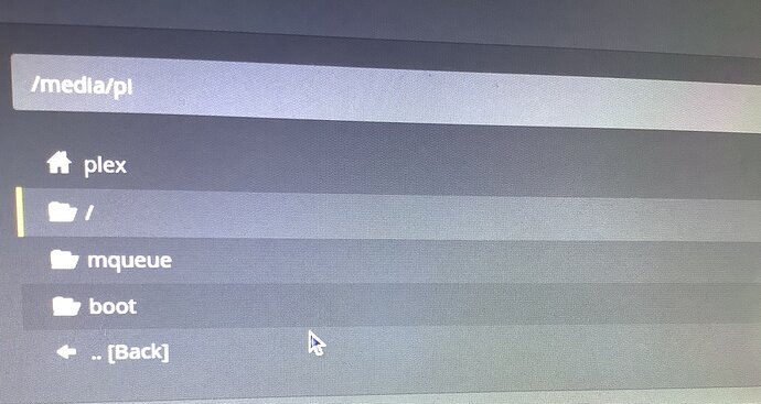

It should be listed in media/pi yes? It’s listed in an open location and goes to nowhere. mnt as you can see also shows nothing?

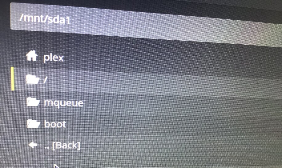

Here it is with what should be the correct sequence after a reboot. Still nothing happens when the folder is selected?
