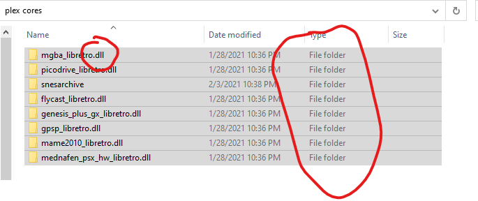

Here is what may be the issue:
WHen you unzip the cores it creates a .dll file folder which plex thinks is the dll. Move the folders out of that directory and place thier contents in the game core directory and restart plex
