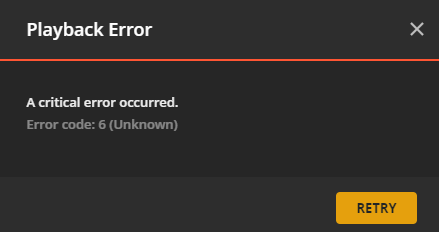

Been having a heck of a time getting games to play on the new Arcade. Loaded some neither the built in games nor added roms will run. Was able to get the custom roms to scan but if I attempt to run any game it just hangs hangs. Only error I am getting is this
The Error code: 6 is a mysterious Parsec error. I wish I had an answer, I only have more questions; hoping one helps!

I am also getting this error. The server has a nvidia 1060, and meets all the other requirements. it flips between this error for custom NES roms. I used the core manager. And it also gives me the error trying the Atari roms. Is there any other further debugging i can do?
So i also get this error sometimes as well.
An unknown error occurred.
Error code: -1073741819 (Unknown)
ok all day of beating this up. I got the things going. I needed to update to the latest nvida drivers. And WAM it all went working. To overcome the network issues i opened UDP 8000-8002 in my router.
