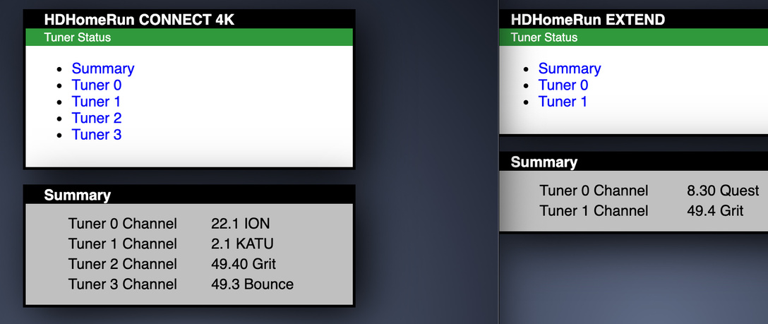

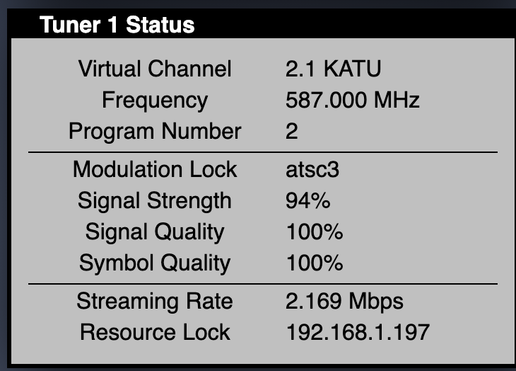

Well, I have both the EXTEND and the CONNECT 4K up and running with Plex. The guide is a tad outdated (not even taking into account the ATSC 3.0 broadcasts we do have here). But it’s pretty slick to have more tuners at any rate :slight_smile: Looking forward to things getting ironed out over time…
Upon reading the forums more, it would appear the audio is AC-4 which isn’t supported yet by ffmpeg and thus likely not in plex either. This seems to be a pretty good roadblock for early adopters
This is almost certainly it. I get audio using the HD Home Run native app, but not in Plex on ATSC 3.0 stations. I do on ATSC 1.0 stations, so it’s definitely codec.
