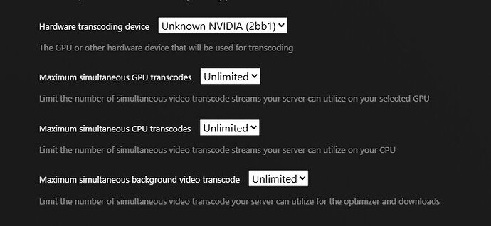

Plex can't identify Video Card (NVIDIA RTX PRO 6000 Blackwell Workstation Edition)
Plec cant seem to Identify
Everything in the OS shows the correct video card though
If transcoding is working, this isn’t really a problem, is it?
Looks like the same problem as I reported RTX 5070 GPU detected as Unknown NVIDIA (2f04).
Seems to be a reporting error as transcoding works as long as you stay in on the public builds, it’s broken on the current beta.
When I tested on one of my Intel 6980s the transcoder had issues with detecting cpu or something, moved back to a intel 8592+ server so you never know what may happen, unlimited transcodes might get bumped down to less or something, who knows. Dont want to miss out on the 96GBs of vram

Knowing the Blackwell GPUs are new and that we didn’t know the device ID info until now, this should be a simple matter of adding the device ID to the Nvidia device list.
The same was true of my RTX 2000 Ada gen when it was first released last year.
Can you please provide the lines from the PMS server DEBUG logs where it finds the GPU on the PCI bus ? (these only appear at server restart)

@techieanalyst
Is this in a container or VM?
Asking because I am not seeing the PCIe bus device come through to the logs
What do you get with sudo lscpi -vv | less and then scrolling down?

Thanks,
Ticket created for Chris.
No rush, it all seems to work
Is it detected correctly on this build? Battlemage Support - #120 by chris_decker08
