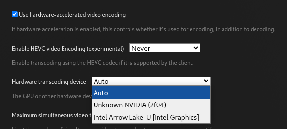

@dokuro
When you open the transcoder settings in PMS to select the GPU,
Do you get the right GPU name or do you get “unknown” ?
Look here: (from my logs)
Sep 26, 2025 14:29:49.344 [126981437877048] DEBUG - [GPU] Got device: Intel AlderLake-S GT1, intel@builtin, default true, best true, ID 8086:4680:8086:3020@0000:00:02.0, DevID [8086:4680:8086:3020], flags 0xbae7
Sep 26, 2025 14:29:49.344 [126981437877048] DEBUG - [GPU] Got device: NVIDIA AD107GL [RTX 2000 / 2000E Ada Generation], nvidia@unknown, default false, best false, ID 10de:28b0:10de:1870@0000:01:00.0, DevID [10de:28b0:10de:1870], flags 0xe8
I get unknown.
Screenshot from 2025-09-26 19-36-48
Within the logs I no longer see the nvidia GPU listed (It was listed perviously when I reported this bug RTX 5070 GPU detected as Unknown NVIDIA (2f04) - #5 by dokuro)
