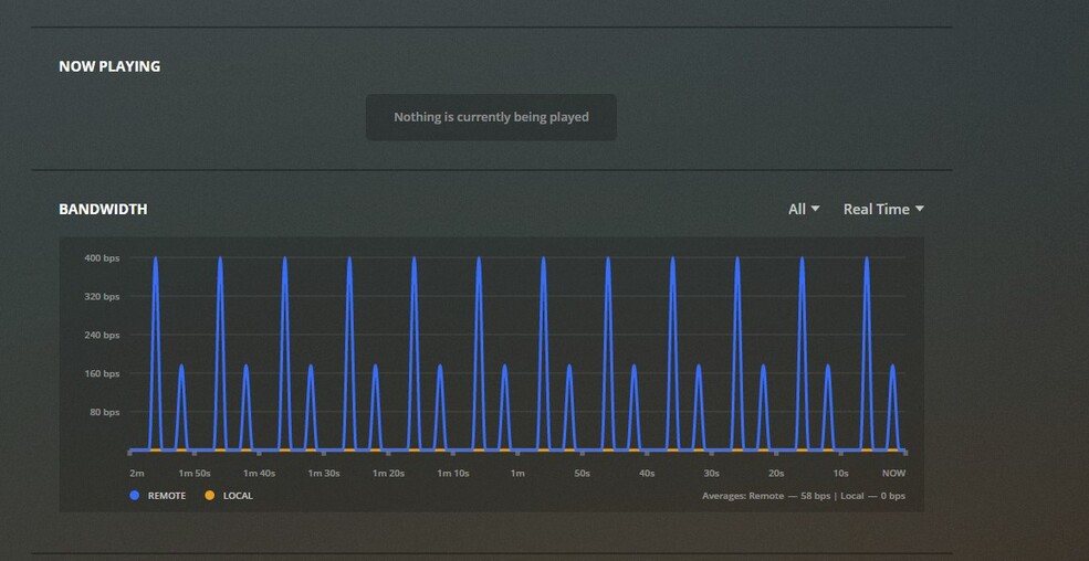

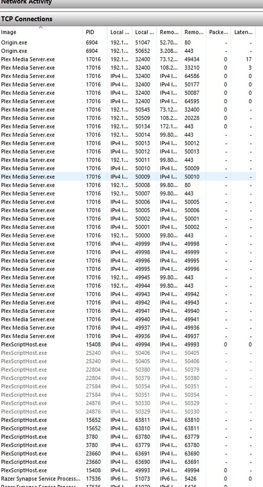

I then started to notice that my computer would freeze even when nothing is playing. Attached is a picture of my dashboard where you can see that there is nothing playing yet there is remote traffic at constant intervals. Also attached, is a picture of the TCP connections that plex is using with nothing playing. If I close plex server the “random” freezes go away. I’ve attached the logs as well.

When it it happens, the computer locks up and I can’t do anything. The mouse doesn’t move and no response from keyboard. I’ve been keeping task manager up to see if any process is hogging the cpu. When things start moving again the plex transcoder and plex media server process are always at the top of the list.

I do not see much activity going on with your Plex server at the time. There aren’t any noticeable gaps in the log. I mostly see a web browser requesting the dashboard information. The issue could be the web browser taking up too many resources. Have you tried closing out this browser to see if the freezes still occur.
No I haven’t. I usually have the site open and just cast to my Roku device. I’ll try keeping it closed and see if that helps.
Having the site closed doesn’t make a difference. New logs attached. A lot of unresponsiveness between 5:08 and 6pm today as there were 3 people streaming during this time.
Plex Media Server Logs_2020-07-01_18-00-53.zip (4.6 MB)
I’m still seeing lots of requests for the dashboard information. You sure you closed out all browser tabs?

I just saw this in the patch notes for the latest version. When my computer becomes unresponsive, it’s the plex media server and the plexscripthost processes that start hogging resources. I’m going to update and see if this helps.
