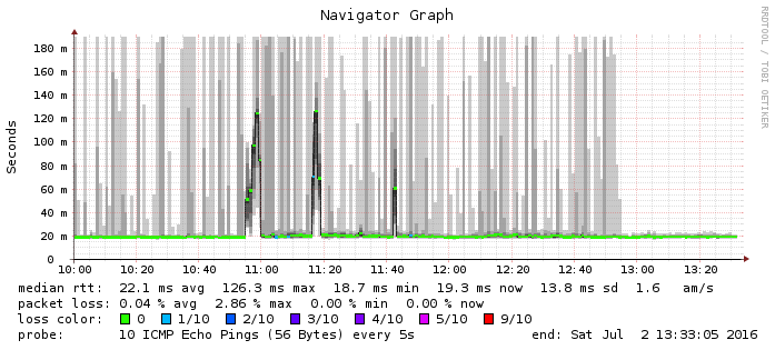

I am also having this issue, with both DLNA disabled and uPnP disabled on my router. I have “Smokeping” installed to track my ping to a remove server over time, which is plotted in the attached image. As you can see, the line goes basically flat once I turn OFF Plex.
