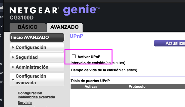

I have been able to disable UPnP and everything works fine now.
I don’t really understand what causes it but now everything is fine.

Glad that worked!
It sounds like your router was interrupting traffic when it got a UPnP request or query. That’s rather embarrassing for it.
Edit: I think I responded to a post that was removed?
UPnP is weirdly vilified. It isn’t fundamentally evil and can be done well.
But a lot of “consumer” equipment is pretty bad in general, and UPnP on top can make things worse.
This router that stops forwarding packets for almost a second? Oh gosh. Yes, turn it off, stop the bleeding. I’d be shopping for a different device based on that alone.
