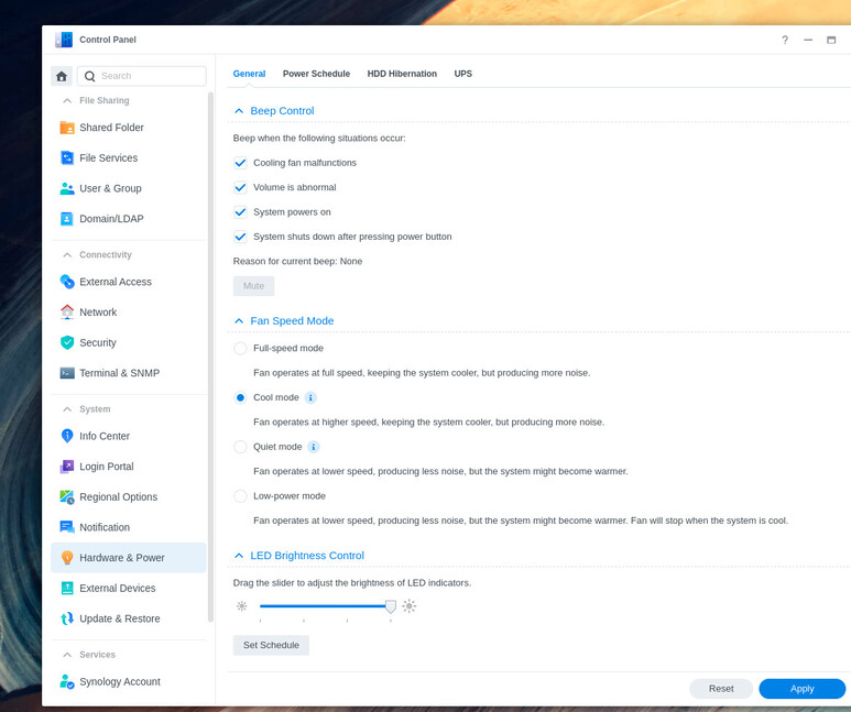

I would like to know where you have it set and, if not in ‘Cool’ or ‘Full Speed’ (which isn’t very noisy anyway, See what happens.
After the first failures I changed to full speed but to no avail. The NAS is just sitting on my desk beside me, away from any heat sources. Also the country I live in is not known for its warmth! So shutting down at 2am is highly unlikely due to any external conditions. The room it is in would likely be no more than 10C at night.
