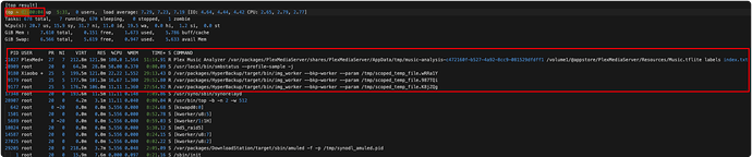

This is the NAS CPU data. We can see since plex schedule tasks starts, the CPU load increased dramatically. And I put the latest maintenance windows at 08:00, we can see CPU usage increased at that time in the graph too.
I am not clear about the “generate intro’s, credit markers and chapter thumbnails”, I just put media in the folder and scan folder immediately to show it in the liberary.
I currently suspect that it is caused by sonic analysis feature, it consumes a lot of CPU and lasts long time.

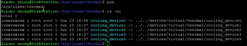

My NAS directory is different from yours:
I found the file. Let’s keep eyes on it.
