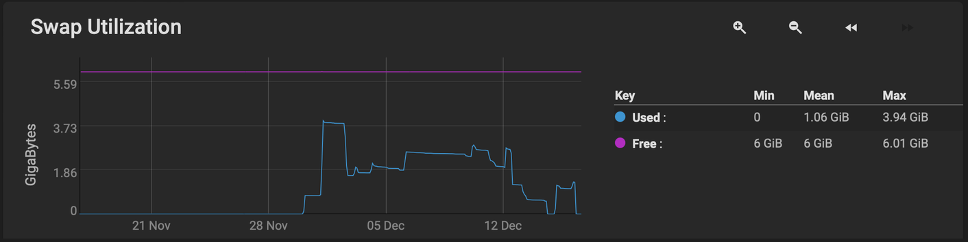

I can see there is a spike in Swap usage just after 3am, but can’t say if thats the cause of the crash, or time, I’ve attached my Plex logs…
Diagram attached.

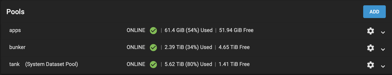

How large is your TrueNAS pool, etc.? I am at 96GB RAM for my 100TB+ pool. Running on 12.0-U6 and don’t have this issue.
So all the media is on TANK, apps are on Apps.
I\m also attaching a Swap usage diagram, you will see swap usage was always zero, up to a couple of weeks ago when a Plex upgrade was done.
RAM use to be 16GB, and stable, upgraded on Tuesday to 32GB after everyone implied this is a lack of RAM leading to SWAP leading to crash… my issue, my media volume have not grown significantly…
The problem of out of Swap, I think it is a symptom, it’s not the cause.

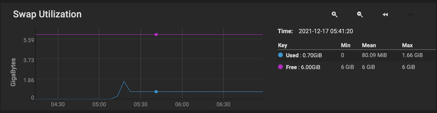

So I moved the the normal house keeping schedule from 2-5 → 4-7 and likewise my Plex crash/kill moved…

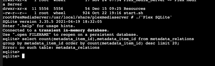

not finding the sqlite binary…
examples does not say where the binary would be in a TrueNAS build.

SQL lite binary for FreeBSD can be found here:
/usr/local/share/plexmediaserver/Plex SQLite
While still present in the running jail, bring up SQLite and run the provided SQL.
can you navigate to the directory where the db file is before launching “Plex SQLite”
Then you .open this file com.plexapp.plugins.library.db and run the sql on that file

OK - it is not that straightforward - the db filename needs to be a parameter to the plex sqlite binary
So you navigate current directory ito
/Plex Media Server/Plug-in Support/Databases
then you launch “Plex SQLite” binary giving it this as first parameter com.plexapp.plugins.library.db
and that goes into sqlite command line where you can type
select count(metadata_item_id),metadata_item_id from metadata_relations group by metadata_item_id order by count(metadata_item_id) desc limit 20
