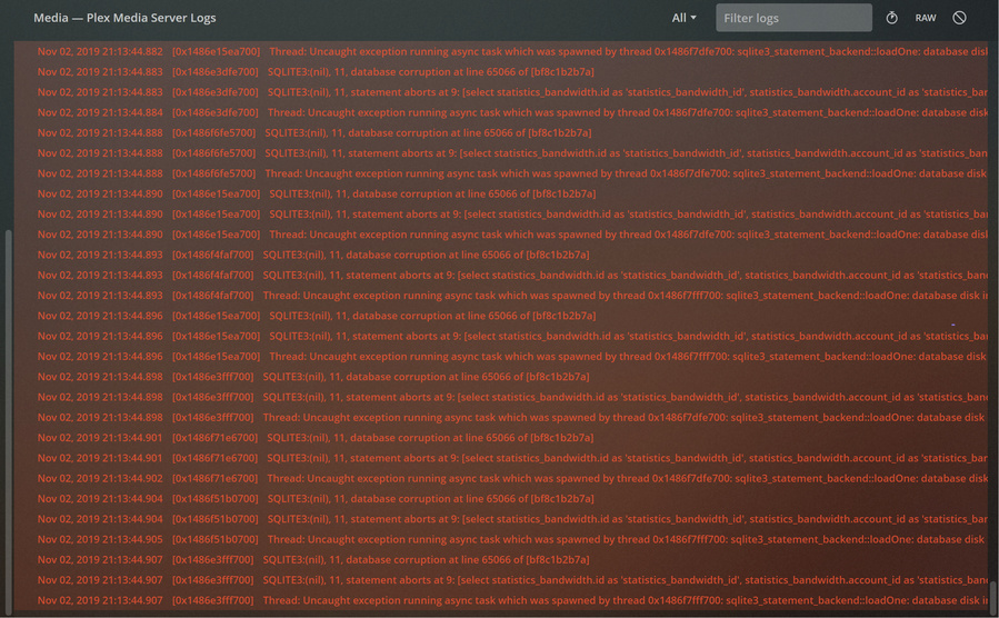

Hi All,
So I have been having some issues over the past few weeks with the database being corrupted. I have had to restore several times. I currently run Plex in a docker container on Unraid (6.7.2). When i first set Plex up i used the container: linuxserver/plex but when the DVR provider changed and I had to update Plex quickly i had to move to the container: plexinc/pms-docker:plexpass. After some googling it has been suggested that this can cause the corruption issues and to move back to inuxserver/plex which I have done. They both were on the same version so I restored my DB, changed the container and all seems to be OK, apart from “Top Users” and “Play History” in the dashboard. These have stopped updating. Having a look around as well I am getting a lot of exceptions on the console, I assume this is causing the issue.
Is there anything I can do to fix the issue without having to set up plex from the start again?
Scott
That worked thanks! The errors have gone and it is recording users time spent now too.
Scott
