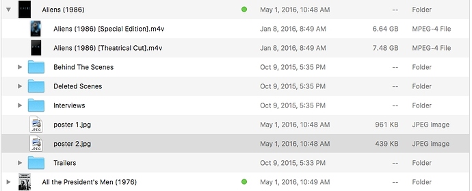

So, here is the most recent problem I’ve been having. Plex is now displaying all of my titles as the file name instead of the title in the metadata. I tag all of my content and therefore have Plex agents set to Personal Media at the top of each list. I use iDentify to tag everything and up until a few days ago it all looked fine. What’s really strange is last night I deleted the library and decided to watch Plex create it and initially it all looked as it should, so I left it and went to bed only to find this morning that it had reverted to using the file names and listing the year as 2016. Here is an example of my file structure.
Here is how it looks in Plex.
I can’t seem to think of a way to show you how it should look, but the examples above should simply display as “Aliens” and “Aliens - Special Edition” with the year as 1986 not 2016.
Also, this is every single item in my library. It lists the file name as the title and the year as 2016.

Also, Plex may not like the folder structure you have going. It might be that dividing up the movies into “A” folders and “B” folders and so on is messing up the scanner. You might try dumping all of your “A” movies into the movie folder itself and see if that makes a difference. I’m not sure it will, and as far as I can tell the naming conventions aren’t clear on that score.
https://support.plex.tv/hc/en-us/articles/200381023-Naming-Movie-files
Your folder structure is fine (using a folder “A” is not a problem).
Do you want them to appear as different movies or as a single film but with 2 cuts?
The multiple version feature in Plex is moe for different resolutions than different cuts of the film
For example:
/Movies /Pulp Fiction (1994) Pulp Fiction (1994) - 1080p.mkv Pulp Fiction (1994) - SD.m4v
REF: https://support.plex.tv/hc/en-us/articles/200381043-Multi-Version-Movies

hthighway, ideally I would like to be able to have one item in the library list that would lead to multiple versions if the the move had them. For example, currently I have five versions of Blade Runner or four versions of Army of Darkness in my library. It would be nice if I had one Blade Runner in the library and was then able to choose from the multiple cuts inside the Blade Runner info page. I wasn’t aware that Plex was set up that way, if it is.
However, that’s a wish list item. Because, right now my problem is the way Plex is displaying all of my titles with the filename instead of the meta data info. My first post has images of what I’m talking about.
