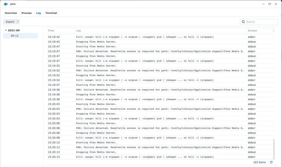

I’m getting a error in the log in the docker GUI.
PMS: failure detected. Read/write access is required for path: /config/Library/Application Support/Plex Media Server
so the server is stopping.

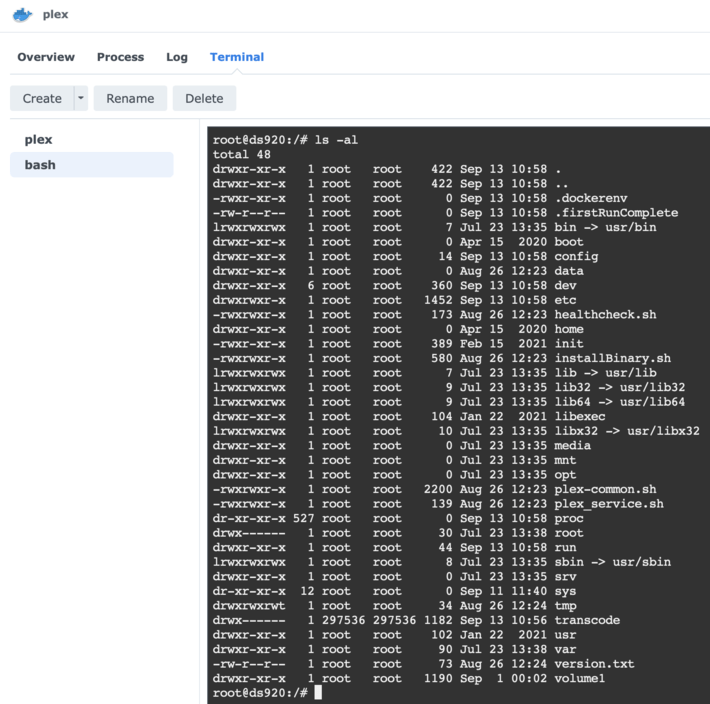

Any thoughts? when I check the permissions within the docker container I can see that it only has rx on the users and groups, and have double and triple checked the GUID and PGUID is set correctly, DSM shows the User ID has RW access to the folders and files?

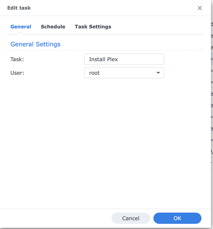

I’m running the command via the task scheduler via the user root
. just easier than enabling SSH each time and remembering to disable it etc. when testing.

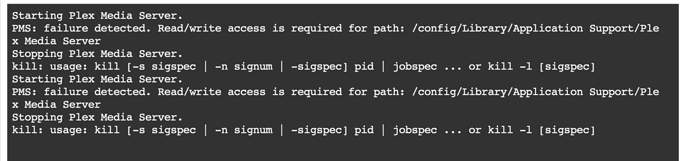

Where is this coming from ?
Are you starting manually or letting the container start ?
I did it one more time from the command line.
I receive the errors in the GUI on DSM.
M.

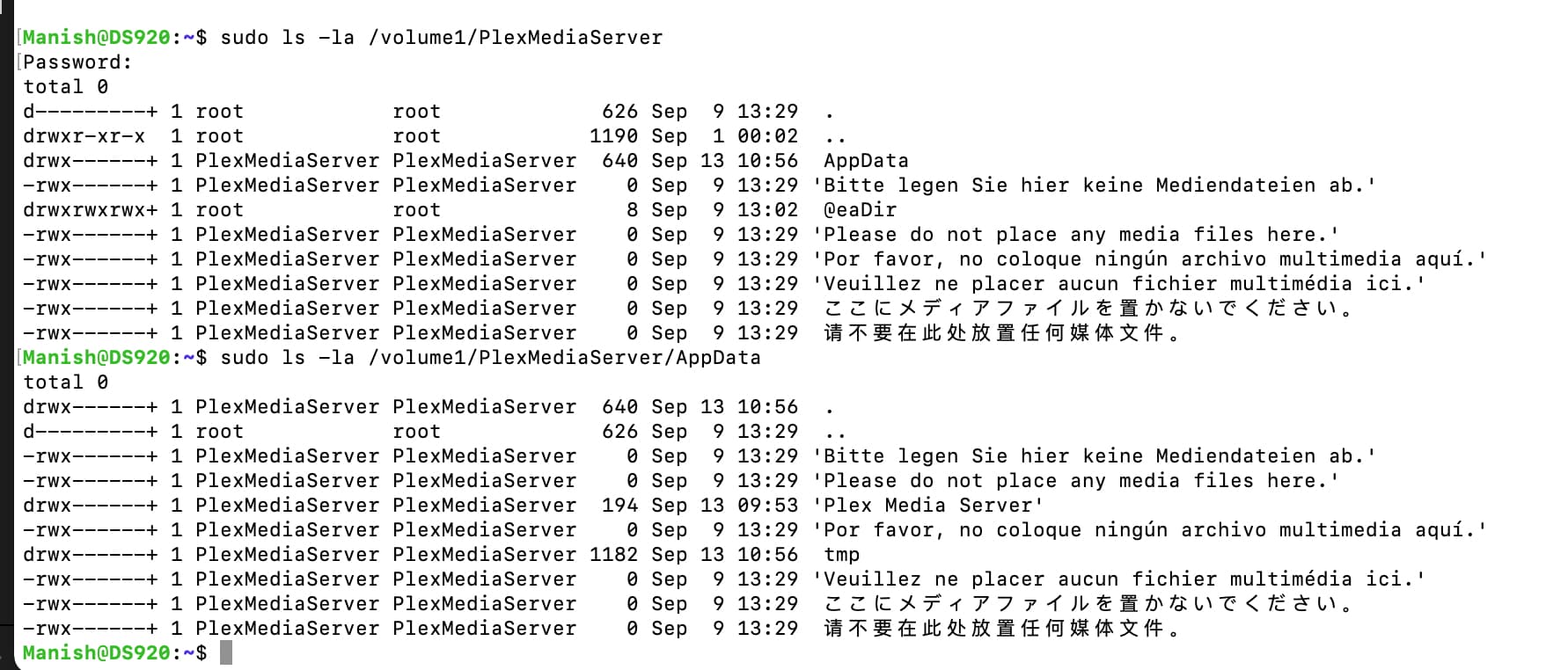

create a task - user-script, run as root.
email the results to yourself.
ls -la /volume1/PlexMediaServer
ls -la /volume1/PlexMediaServer/AppData
Here ya go.

The permissions for you PlexMediaServer shared folder are broken.
drwxrwxrwx+  1 root                root                      626 Aug 18 10:33  PlexMediaServer
I’ve checked multiple systems here and all are this way.

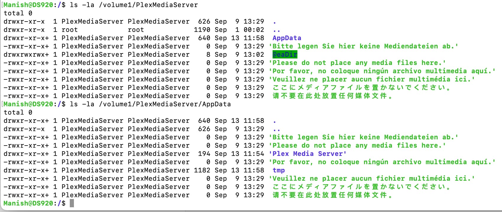

Let’s attempt remedy. This is not going to be elegant
  1. Stop Docker and PMS native package
  2. User-script -
chmod 755 /volume1/PlexMediaServer
chown -R PlexMediaServer:PlexMediaServer /volume1/PlexMediaServer
  1. After running–
  2. Restart Plex Package (DSM will repair permissions as needed during package start)
  3. Stop
  4. Docker GUI to start package
Hmm,
Not sure why it’s still giving me the same error. Your Logic and commands make perfect sense, however I’m still getting the same error after assigning the permissions.
